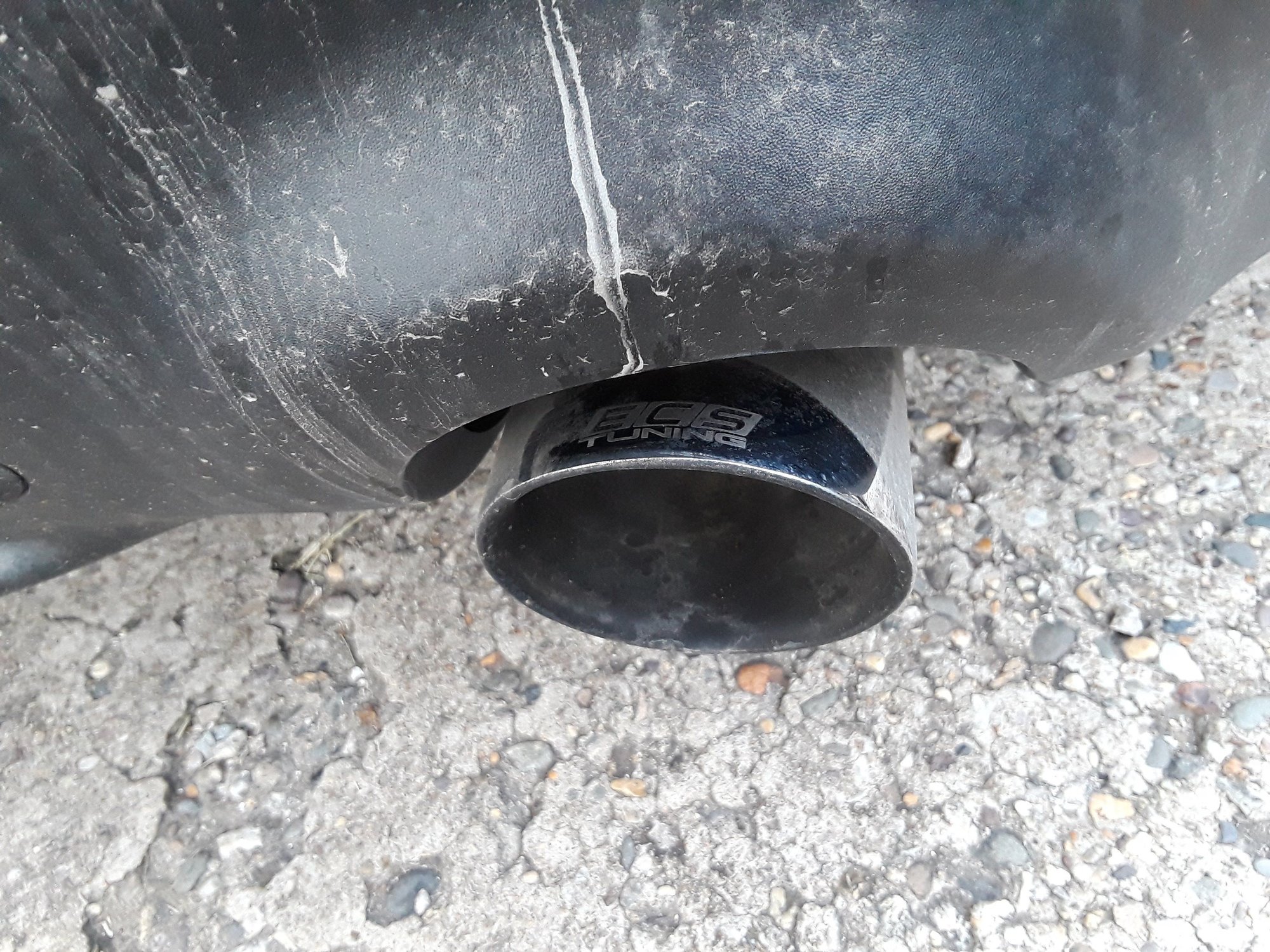

The unfortunate fact is that some people are inherently destructive and wish upon them what they do to others. Someone stole the keyfob and the engine oil cap (aluminum cap/after market looks nice). Upon further inspection, The car seems to have been tuned. big intercooler, dp, and big muffler tips. there is also a boost gauge and a button on the side. The previous owner also painted the brake calipers and looks like the suspension is dropped a bit. it sits as high as my clubman!

Over the weekend, I got the carpet back, installed the dash, center consul, and the driver seat... I took it out for spin and I have mixed feelings . The only thing that bothered me was the exhaust system. It is a catless and muflerless system. It is loud and feels like it is reducing the power of the engine. Not sure if the ALL4 is making it that bad but for the big intercooler, I thought I would feel the G forces! I didn't take it on the highway because the rear suspension was knocking where the old rear control arm broke.

based on realoem.com the exhaust system is the same for both.
The car seemed to have few goodies installed but they where either taken off or stolen. The shock tower brace was gone and the intake box was gone too. Even with sport mode, the car does not pop or burble. For now, the focus is on the rear right suspension so I can drive the car and have it inspected.
