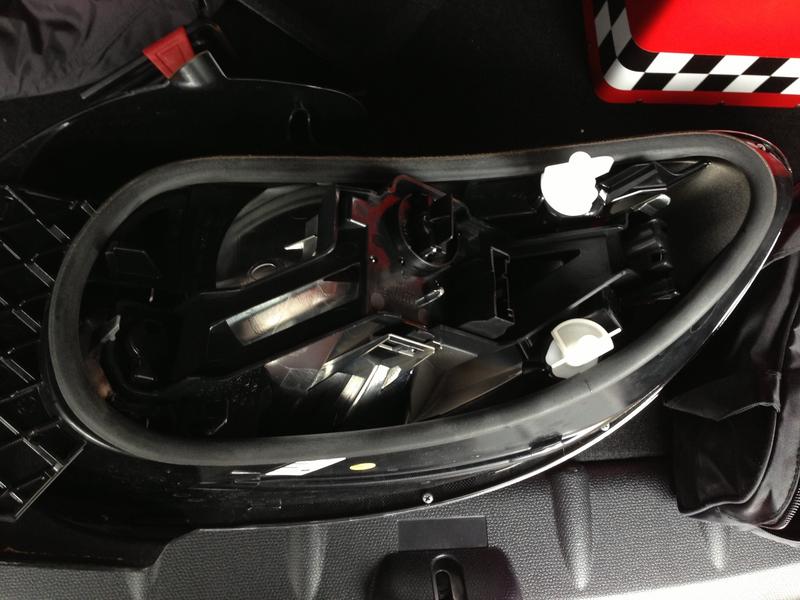

I did find out how to elegantly remove rear chrome rings. Here is the run down (for a left side):
1) unscrew two black screws on the (right) side between the light housing and rubber boot seal.
2) remove mesh pocket wire inside the boot on the (left) side (just as owners manual points out!).
3) remove the "wall" cap behind the mesh pocket by gently squizing and pulling and tugging (no need for screw driver violence,).
4) once opened, have a flash light handy and look for WHITE PLASTIC "****" (sort of a funny shape with "half ears"), see attached photo showing "hidden" side.
5) when located, turn it one direction possible (it's easy) to have the "ears" go freely pass metal wall of the car).
6) now tricky part: there is another WHITE PLASTIC "****" of the same kind on the higher point of the light housing inside, not visible by human eye in no possible position. So, you have to go by touch and find it in the deep poscket of your car's belly... Once you find it with your fingers, turn it kinda half way (same as the first one). Done!
7) grab the entire light housing from the outside and gently "wiggle" it until its OUT. DO NOT PULL TO FAR FROM THE CAR!
8) unhook wire harness (one black plug) for all bulbs. LIGHT HOUSING IS FREE NOW!
One observation: chrome rings are connected to the light housing by screws (!). So, no prying them off like older or different light rings on older MINIs. These have to be removed properly by unscrewing all screws along the inner edge. It is pretty simple once you turn the light housing on it's "belly".
I did not do full removal as I still don't have my matte vinyl handy. Once I do, I will do the DIY all the way.
I hope this helps everyone who is considering wrapping or painting the "horrid" rings...

Thanks for your run down.
That's right. There are no clips to remove. You must unscrewing the screws.
But you can only remove two of the screws after you remove one plastic wall.
This fluted plastic thing is on the far left side of you photo.
It is fixed with clips.

DIY project completed!
Got my Matte 3M vinyl today, and could not wait...
Rear lights removed, and taken apart to the point that chrome trim was on its own....
What a crappy design! Oh mine!
Never saw a light box assembly so screwed up to be taken apart. That plastic wall Martin was referring to is jammed by friction in its place and all parts are non elastic plastic so it is really nerve racking forcing it apart. There is no way explaining it in words. You just have to look at all the edges and groves and go by logic. Still, it is crazy scary...
Once you release one edge, all goes easier. Still, it is plastic and you have to be careful... That plastic curbed wall has no screws, only groves and pins. Good luck!
Once the wall is loose, you can unscrew ALL screws that hold the chrome ring. Again, you will not be able to do at least 2 screws if you don't remove curbed plastic wall...
Wrapping part was another hell raising part. The chrome ring is so curbed on many levels. It takes a lot of patience to do it neat. Lot of pulling and tugging. Finally, I succseeded ...
Then putting it all together. A bit easier, but still scary because of that damn plastic...
All together, very happy with result. But if I never have to take those rings off again, I would be very satisfied...
