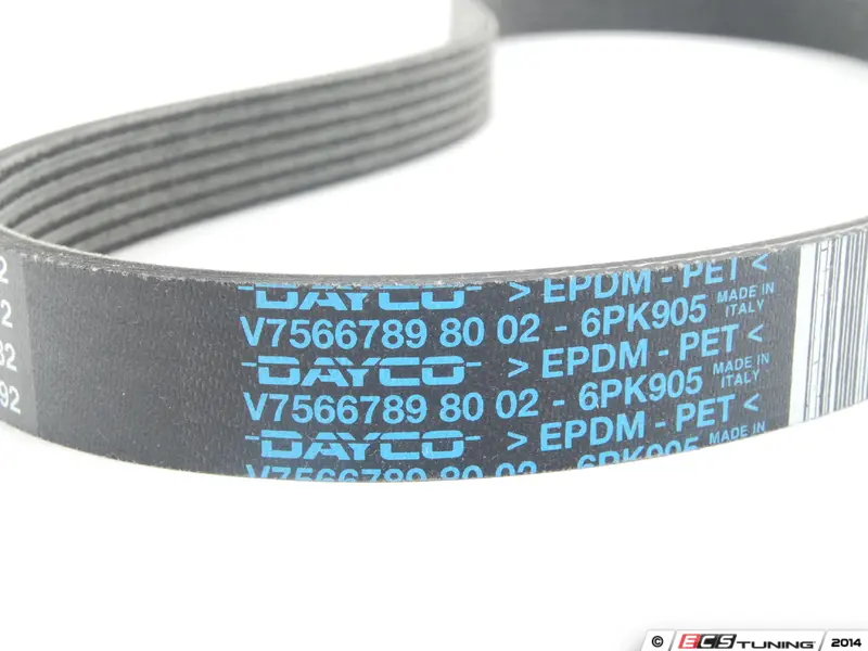

Just going off of their options I saw on RealOEM, they list the compressors with the belt numbers (X905 or X895). After April of 2010, there was a change it seems. It lists the compressor and belt where the belt appears to be the shorter (part number X895) than the other (X905). So I would assume this potentially correct one would be the smaller pully with the X895 belt as listed:

Best bet is to look at old belt and see the marks for the length, on the outside of the belt they are printed with the Size and it will have 6 or 6PK and then the size or a part is aftermarket that crosses to the size. Even when worn you can see it from the top of the engine or under side. X905 or X895 that's the length in MM. Dayco Italy is the OEM for the Gen 2 MINIs BTW.
