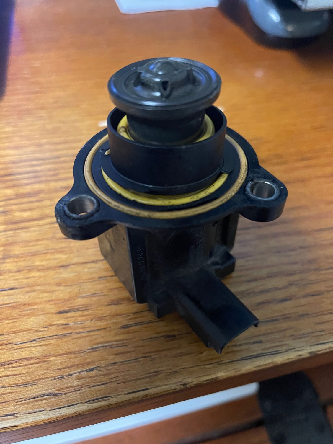

Any codes? If it is anything like what I just went through it’s your diverter Valve. I drove 300 miles home, and kept it out of boost. I was able to get the half check engine light to turn off, but could not use any boost or it would pop back up. Replacement should be here today.

I lost my DV on the tail of the dragon, shifting into third, heading into the first turn just above the store, so like a quarter mile in. I gently got her to the first pull off and didn’t see anything crazy. I have a dv spacer and intake, and when I got into any boost I could here the dv fluttering.
For you, I would drive it to the shop, be as gentle on the throttle as you can, shift at 3k, try to keep it out of boost.
Or if you have some tools, it isn’t that hard to get to the dc to check it, had mine out in 5 minutes. Moving the coolant reservoir around is the hardest part of the job really, if you have the proper tools. The bolt heads are either a t30 or 5mm hex key.

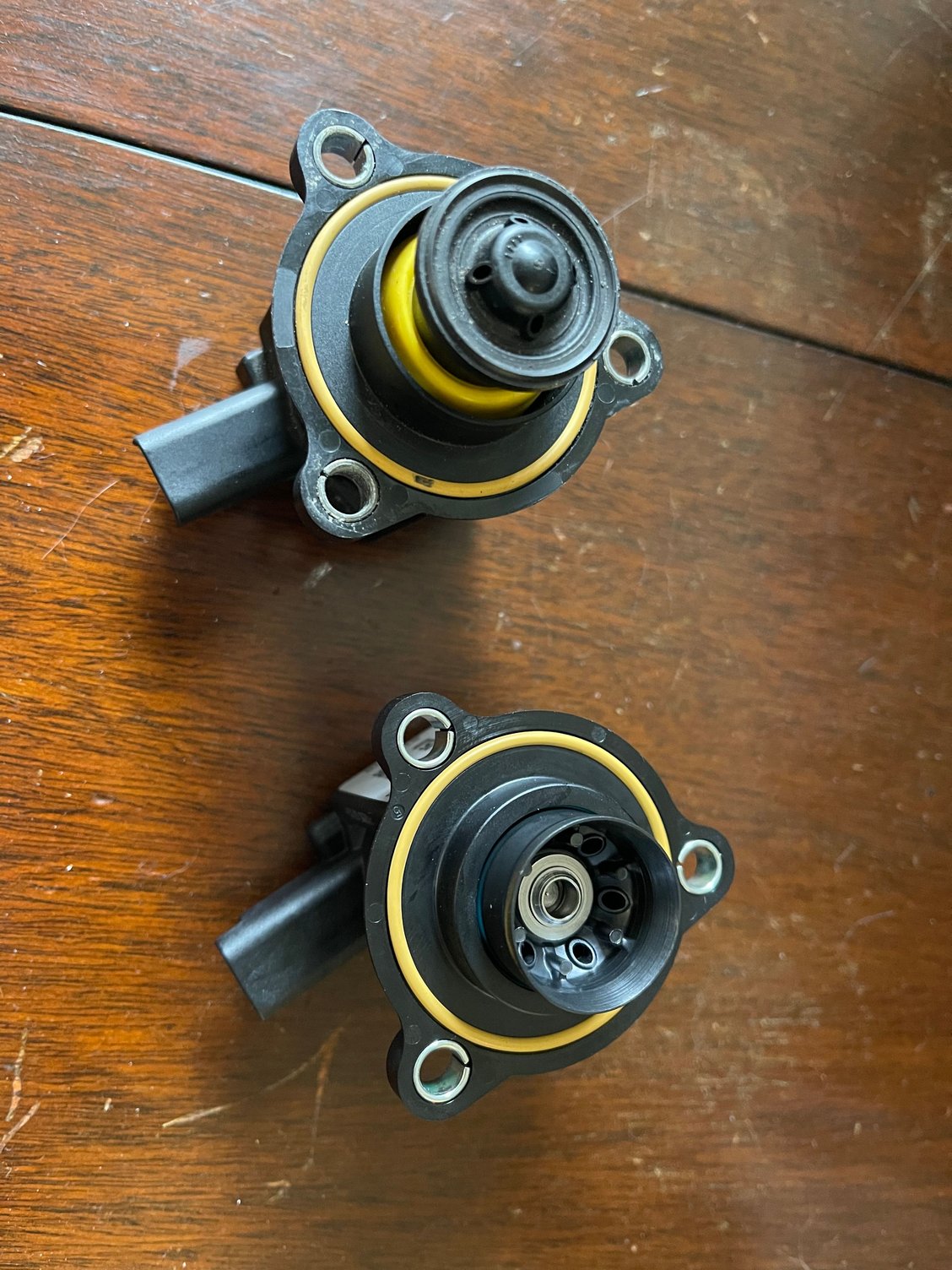

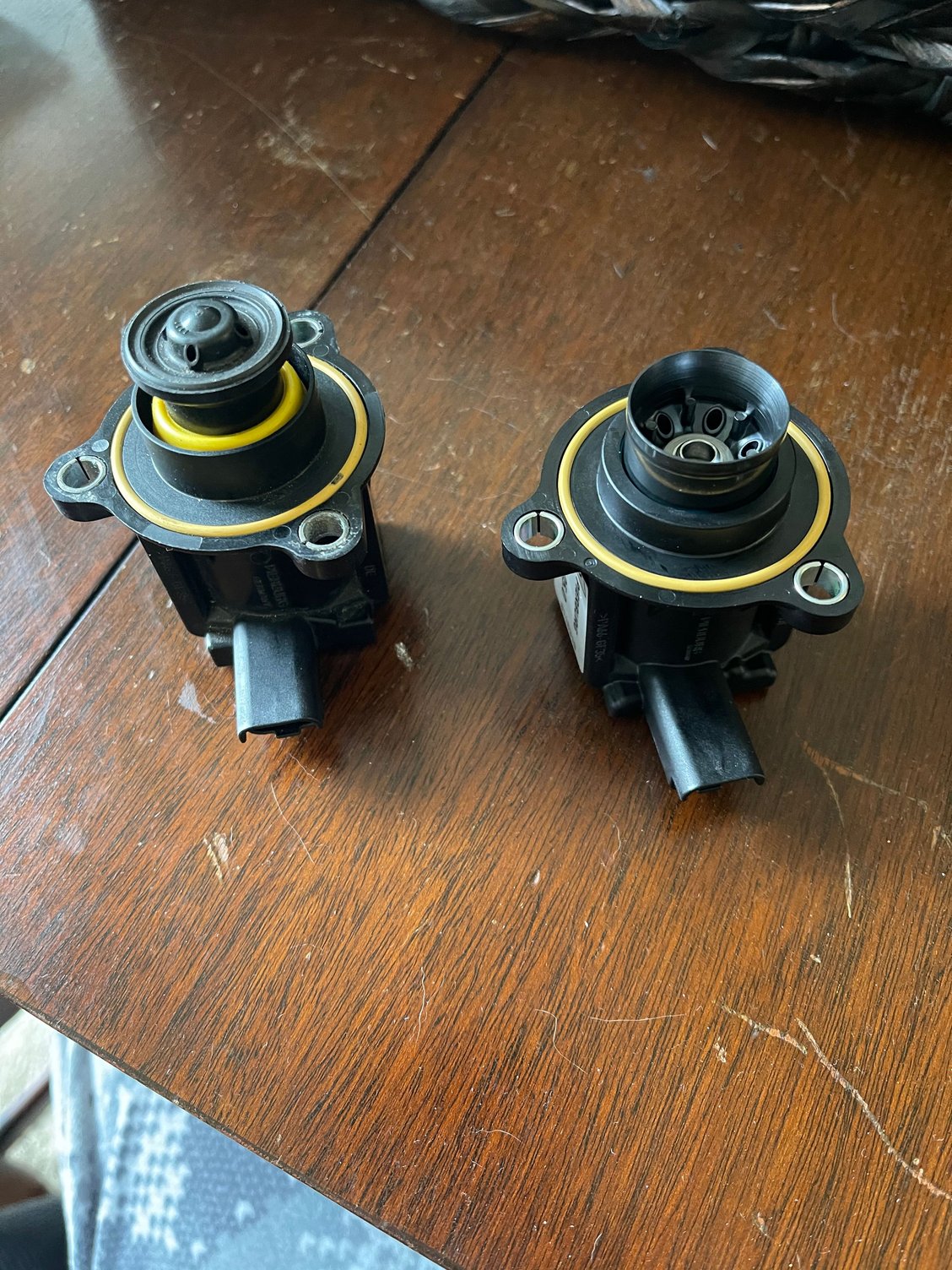

Old Mar 12, 2021 | 04:47 AM
Jason Cornelius's Avatar
Jason Cornelius
Joined: Dec 2019
Posts: 2,107
Likes: 691
From: Cincinnati, OH
Hey, so I just replaced mine yesterday took about 15 minutes to put it all back together. This is something that you seriously could check in 30 minutes or so on your first go around. There are 2 different designs on these things. ECS Tuning has the new style pierburg’s for like 40 bucks, and I remembered another forum member, thank you again Nik, had one laying around. You might be able to find a used one, like I did, to have as a spare in the glove box for next time. And I was able to swap my Alta boost spring over with no issues.
New style on bottom
New style on right, old style on left will be my spare.
