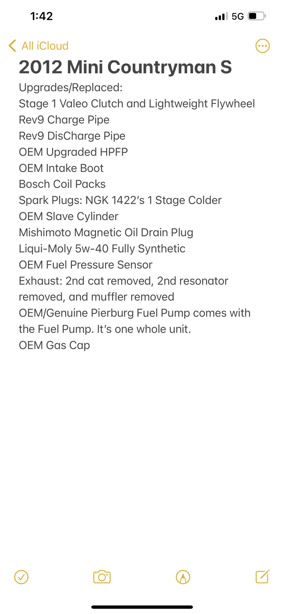

Hello all, I just ended up getting a new scanner for my car(Autel MD808p) to figure out my issue. Is there anyway anyone can help please, here is what I have replaced and here are the codes:

Weird. I would have said your hpfp, but see you replaced that.
I think you need to figure out that fuel pressure before anything else.
does your scanner show you fuel pressures?

Well the HPFP was replaced about a year ago. Wonder if it failed again already, and I’m not sure I will go through it and check tomorrow.
