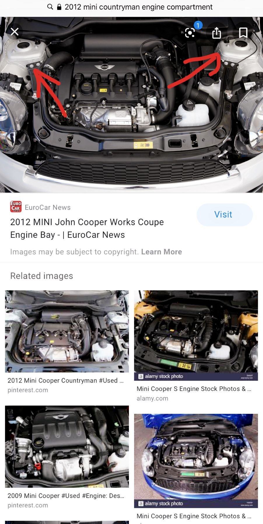

What are these parts?
Sometimes when I’m driving I’ll notice a burny smell/like something just isn’t right. Not sure if this is normal or not, I know it’s probably not. I was looking around the engine bay and noticed that inside the silver thing the arrows are going to, it is cracked around the cap/seal. Not sure what they are if that might be it.
i also just got my oil changed two days ago and the engine cap had some gunk on it that I wiped off to see if it reappears. Thank you all for your help.
*Picture is not my car*

"the silver thing the arrows are going to" are the shock towers. The rubber bit on the inside is the actual shock mount. If those are cracked, they need to be replaced before your handling goes all wonky.
If there was "gunk" on the oil cap, the monkeys that changed the oil might have gotten oil on the exhaust. That could be the source of your smell, but it is near impossible to diagnose a smell over the internet. (almost as difficult as diagnosing a noise)

Yes the rubber on the inside is what is cracked not the metal. What can I google to find the parts themselves and is it difficult. The smell comes through my air vents into the cabin. It’s not from the exhaust.

Just got out of work here is a picture of mine just to confirm one last time before I buy the part.

Michaelh
No need to carpool yet!
That mount is beginning to fail though, so I'd arrange to get them both changed when you can.
I'd use an independent MINI garage & have them check for 'mushrooming' of the towers while they are in there.
Meanwhile, tighten up the 3 bolts on the top of each tower - it looks like at least one of them is loose.

'Mushrooming' is the top of the shock towers being pushed up - the 3 bolts should be perfectly vertical (& tight!).
It's a very common problem & there are many threads on here - just search for 'mushroom' & you won't be kept in the dark.
