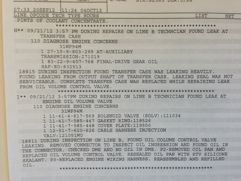

Add another user to the list.

Mine is in now for gearbox and transfer case. Brought it in for the temp sensor reacll when they found the leak. They put in a new seal which didn't work because it began to leak oil heavily. Brought it back and they told me they have to replace the gear box and final drive. Thank God for warranties. Could be a huge problem for Mini.
