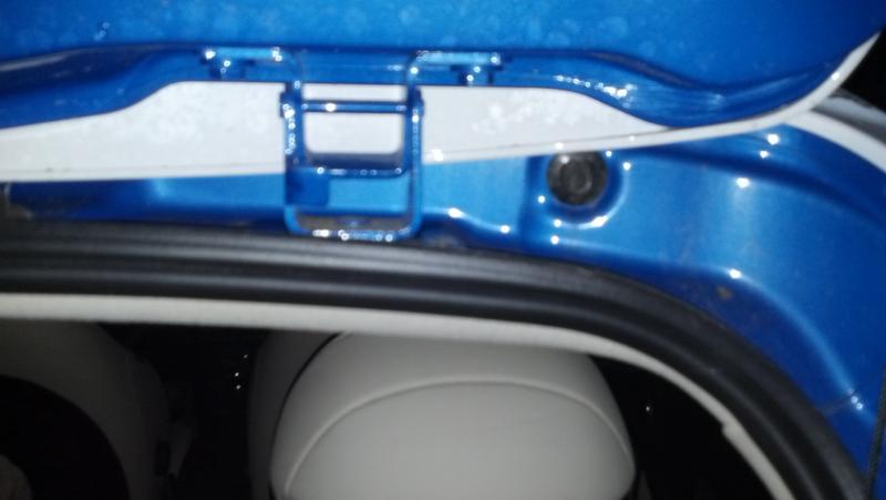

I have two "flaps" !!
One on top right, one on upper left .... Do I Remove both "flaps" ??

I just took them both out completely.
They're just wedged in there - pull 'em out!

I plan on removing just the thin flippy little "lid" which sits on top of the plastic "ring" -- Are you suggesting "digging out" the entire plastic ring which inserts into the actual body of the Mini ??

I'd take a photo for you, but it's just not complicated...
Pull the tab out - the little plastic holder (smaller than a dime) will come out with it.
Don't remove anything else, especially not the rubber!
