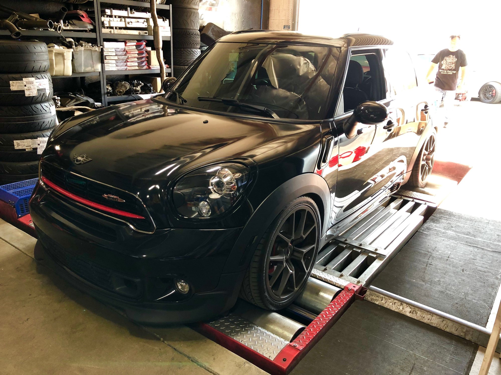

I’m running stage 4 RPM Power Tuning with our new 400whp turbo kit
Mario
mQubed Motorsport Manic & RPM Power Tuning

From: Toronto, Ontario, Canada
Whoa......... that's totally exhaust **** right there?!?! I don't even want to ask what that 400whp build costs.
What stock bits are being upgraded to handle that power Mario ?
Noticed the "Made in Canada" markings. Very cool.
