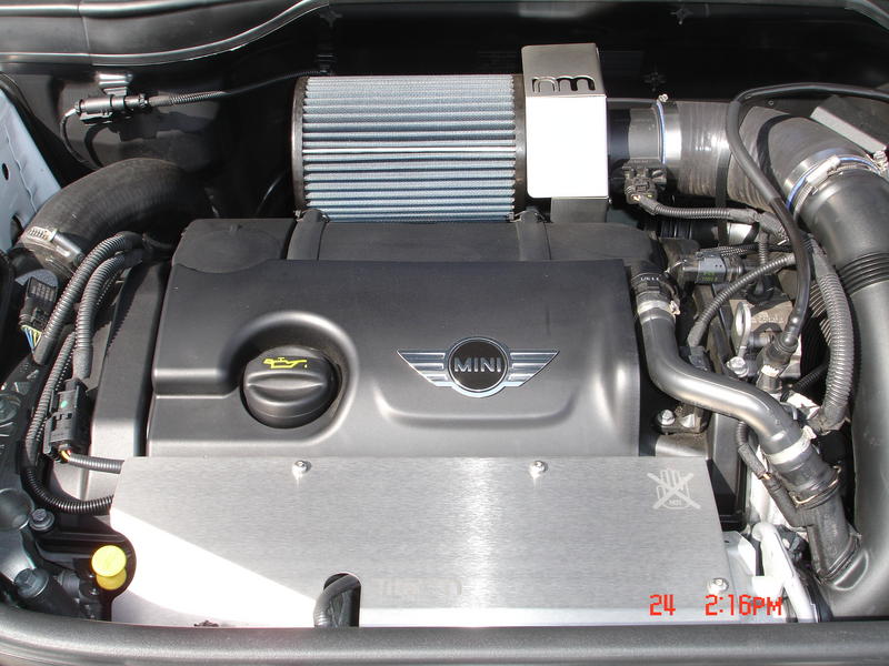

Installed everything this morning...except the turbo heat shield. I dont want to modify the plate cover. I might order a replacement engine cover if they aren't too spendy and mod that one. Too bad, it would have looked nice.
One thing to note on the VIP CAI kit. I had to dremel the lower intake tube slightly to get the rubber tube supplied by VIP to go completely over the intake tube. Nothing major, but worth noting. The engine compartment isn't as tight once you get the airbox off.

You can actually run without the plate cover with no problems (I did that for a while, before finally just trimming the cover).

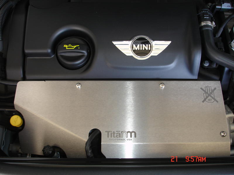

Cool NM CAI & Heat Sheild
Hi Solar10,
I installed NM CAI & heatsheild. I don't know if I was suppose to, but I was able to install heat sheild without trimming cover.
Attached Thumbnails VIP Combo #1 Ordered! CAI, strut brace, turbo heat shield-dsc02699.jpg   VIP Combo #1 Ordered! CAI, strut brace, turbo heat shield-dsc02644.jpg   VIP Combo #1 Ordered! CAI, strut brace, turbo heat shield-dsc02701.jpg

The NM heatshield is slightly shorter than the VIP.

The stand-offs have to be different too, yes? Angled maybe on the NM? It seems like the stand-off posts could be made to angle towards the turbo just slightly, enough to clear the cover. I'd be ok with the turbo shield overlapping the engine cover a little. I was too excited to put any thought towards it Sat. morning. All I wanted to do was drive.
