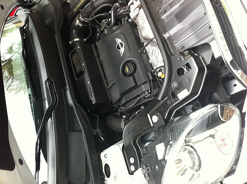

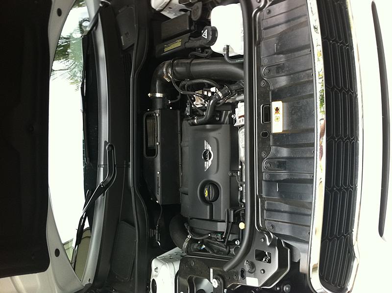

Ok , guys I promised pictures. I'm sorry it took long, but I was buried with work, and haven't had time. Yes, I forgot to mention the Countryman's airbox is slightly different, but I had saved the full air box off my previous Cooper S, had to salvage something from the accident but it is a direct swap, just put the countryman sensor in, and everyhting else followed.
Attached Thumbnails Countryman S with DDM Works Ram Air intake-img_0879.jpg   Countryman S with DDM Works Ram Air intake-img_0880.jpg   Countryman S with DDM Works Ram Air intake-img_0881.jpg

those are all the pics enjoy.

Looks good, did you run anything to get air into the box or is it just open?
Old Mar 7, 2011 | 09:58 AM
CooperSdriver's Avatar
CooperSdriver
Joined: Apr 2003
Posts: 278
From: Miami
No I don't have the ram air because the countryman doesn't have a scoop, although the inside of the box is layered with insulating tape to keep the temp down. I have measured on more than one occasion and the air inside is much cooler, plus more air getting in due to the filter.

From: Phila suburbs
Where did you measure the air temp from and what did you use to measure it? Did you measure it while driving the car down the highway? It doesn't matter one bit that the air box is insulated. You are defeating the purpose of that cai by drawing in air from the hot engine compartment. You were better off leaving the factory air box on which drew in outside air. You're actually lowering your horsepower by drawing in hot air. If you don't believe me then go put your car on a dyno with the current configuration and then dyno it with the factory box on.
You're best bet is to figure out some way to install a hose or whatever to draw in fresh air. Let us know if you get something figured out. It's a shame that they don't have any vent system on the cowl. I love the DDM system on the R56 and Clubman. Maybe DDM will design a retro fit kit for the CM's cowl. I'd definitely buy one then. Until then I'll sit tight.
