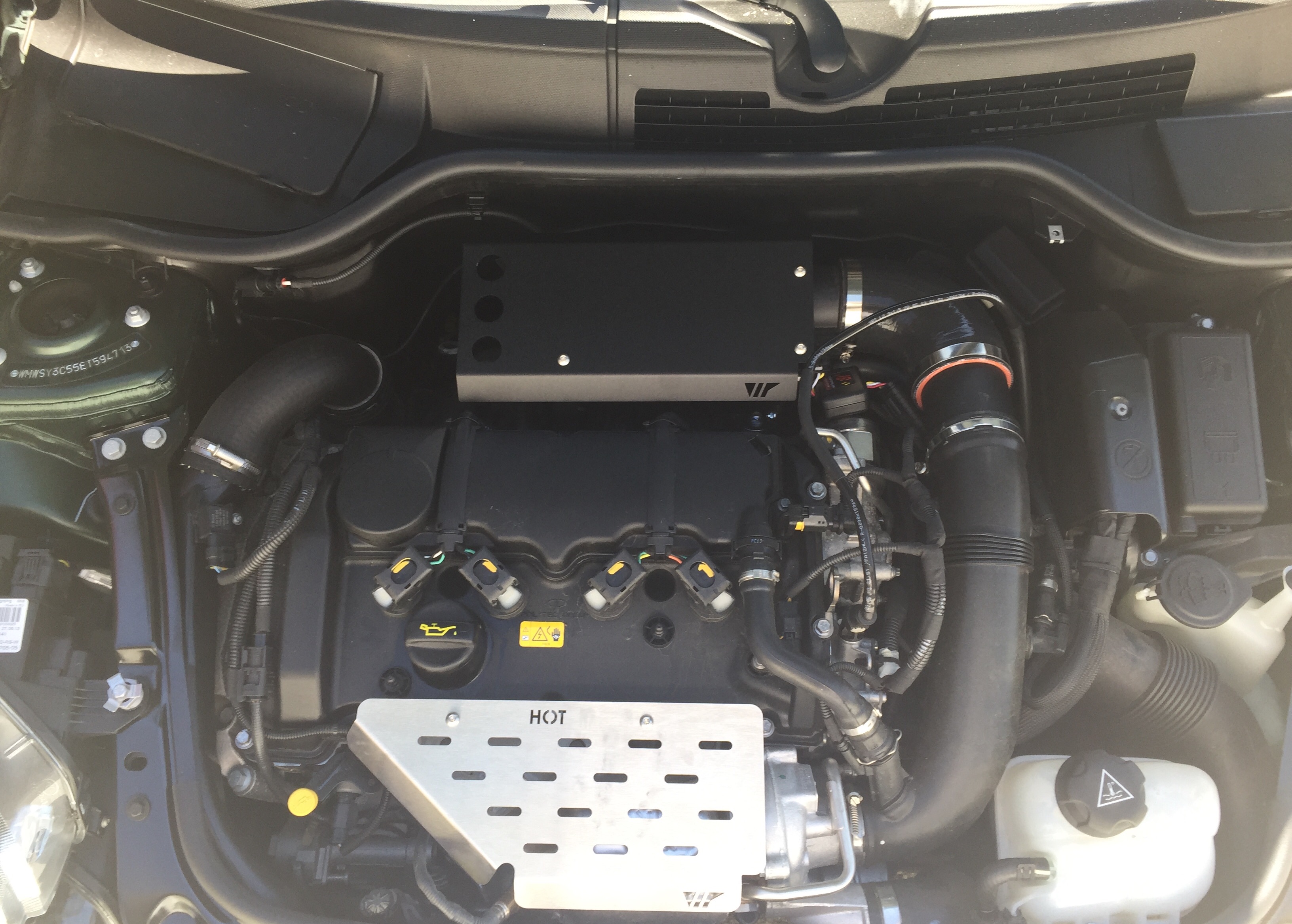

Today I put in a JB+, P3 OBD gauge, turbo heat shield and open element intake filter. Quite the improvement, boosting up to 17PSI, and holding 12.5-14 all the way to redline now. Tomorrow I'll get my improved intercooler piping installed. Wagner Comp Intercooler and 42mm turbo will be next weekend and then finally I'll get my downpipe and manic tune installed in probably two weeks. Final piece I need to source is a meth kit, I blew up a perfectly good 400whp 2.0L motor because of a bad tank of fuel in AZ, car was fine for 55k miles and one bad tank cost me, not going to let that happen again!

Your engine compartment is way too clean.
BTW-that white pin shows up in your picture. In the upper left corner of your picture, it is just to the left of the top strut nut. The tower itself is already slotted to make this camber change.
