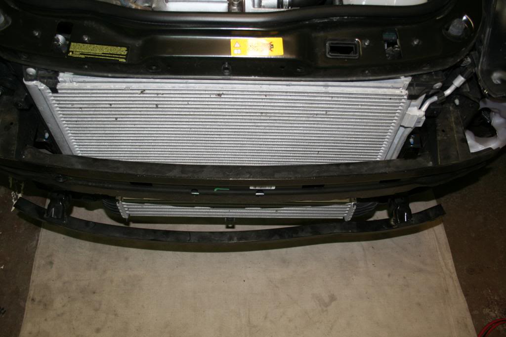

I've been spending a good portion of the day trying to sort this out, making decisions, looking for input, prices, understanding, etc...
It sounds like it my be best to change it myself. I'm confident the rest of the car frame is undamaged so replacing the front bumper frame might be something I can handle (no welding needed, just bolt on).
I've put the parts togethers minor a screw to let the plastic bumper parts lay the way they should.
It's actually interesting that if the lower metal bumper frame portion wasn't there it likely would have resulted in a lot more cost due paint body shop and many of the front parts, painted bumper, intercooler, radiator, might have been damaged.
So all in all I consider ourselves lucky on this one.
After all is done I expect all the repairs to end up roughly around $650-$750 if I do it all myself (including the front spoiler trim I allready ordered and received). In the long term that sounds like the best approach. it probably could be bent back but like everything in our modern days it's probably cheaper to trow away and replace...
In the end what matters most is that my wife is safe and that it wasn't a bigger accident. From that angle that cost is minimal in comparison. It is still money I would have rather spend elsewhere but these things happens to most.
I'll keep you all posted on the repairs. I certainly hope I won't find more surprises once the whole bumper is off. I'm confident I won't but let's not jinxed it

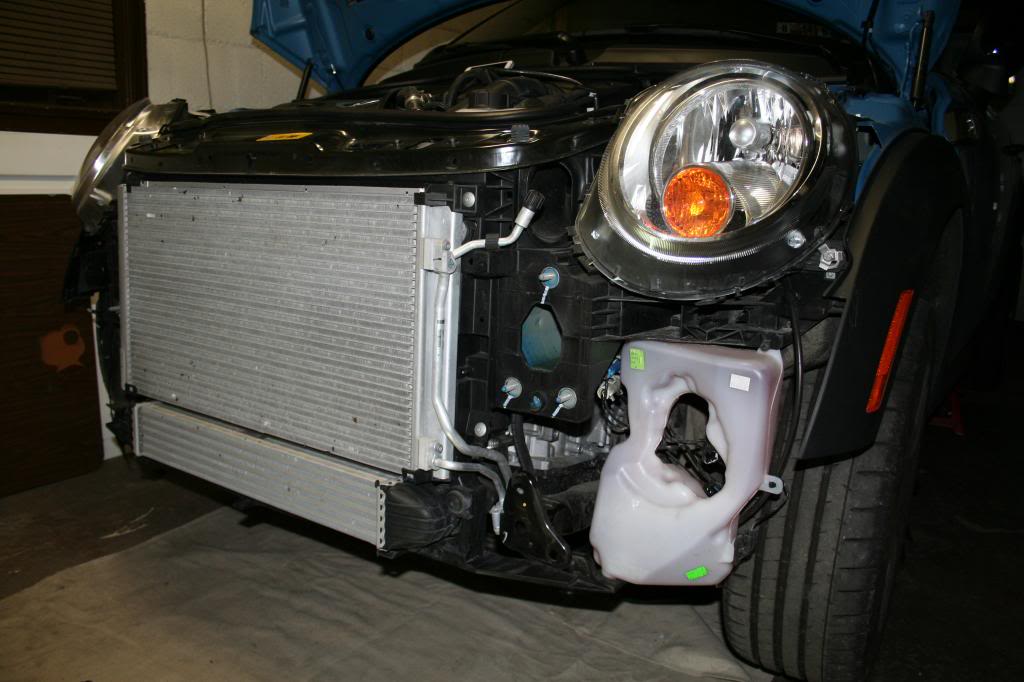

Look at the Helix video. It's a good start. Lots of plastic push pins. Taking them out without breaking them is the hardest part. Probably a good idea to buy a few spares before you start, they are only a few bucks.
Here is the link to the Helix intercooler install.
Scroll down to see the Youtube video.
http://store.helix13.com/helix-stepp...r-mini-cooper/

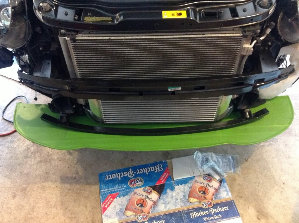

Okay, mission accomplished! I spent the entire evening replacing the bumper inner frame... The car is back to its new self
Replacing the frame itself was pretty easy.
Removing and remounting the bumper wasn't so much fun.
But everything considered it wasn't too bad since I was able to do it in one evening. I was prepared to finish in the morning but that did not happened so over all that was definitely worth doing myself...
Oh, and I could not use the lower crushed tube since for some strange reason the bolts were not threaded :confused5: . . . maybe they are self threading but since I wasn't sure I decided not to take the chance to damage the bolt.
Of course I checked very well the current one and it seemed perfectly fine with no deformation so I feel fine about not having been able to replace it.
