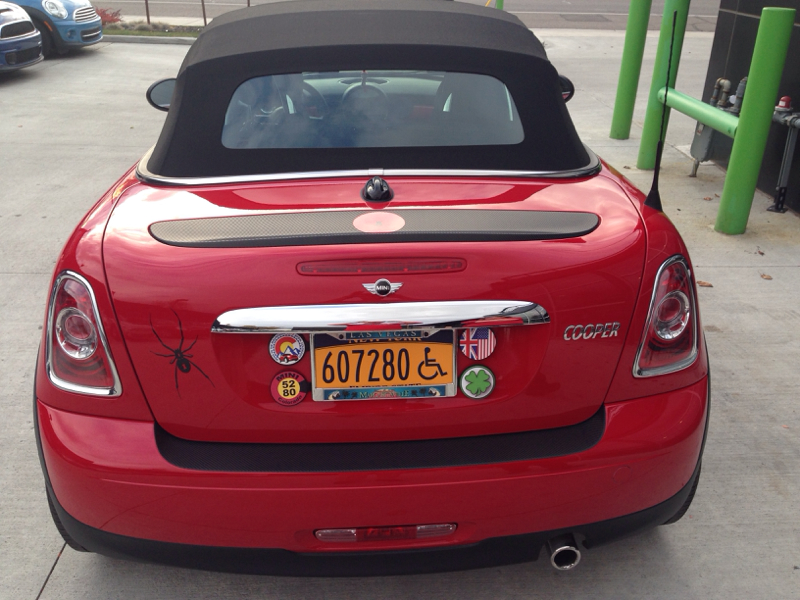

After trying to adjust the boot lid, my MINI dealer finally sent my R59 to Motoring Skins (world's best Graphix guys!) and had them put a sheet if carbon fiber and a thin band if clear bra material on the back to prevent rubbing.
The thin clear material is on the bottom of the boot lid, so it won't rub away the paint. The carbon fiber piece not only protects the bumper, but also adds a uniqueness that ties in my carbon fiber spoiler.

I would have left a small 1/4" or more of bumper rim around instead of laying it all the way to the edge of the bumper valence but real I'm extremely peaky. It looks great!
Now how in the world would the boot edge meet the bumper. That sounds really odd. Is it when driving or all the time?

We are assuming that either the spoiler is pressing the lid way down, or the bumper is flexing up at high speeds.
We had opened the gap a lot, but we were still seeing a minor rub.
Maybe I should drive slower?

It's right where the lid edge and the bumper are. In the picture, it's where they put the carbon fiber on the bumper. It will appear as a misty line of light scratching. It would have eventually worn through the bumper and taken off the paint along the edge of the boot lid.

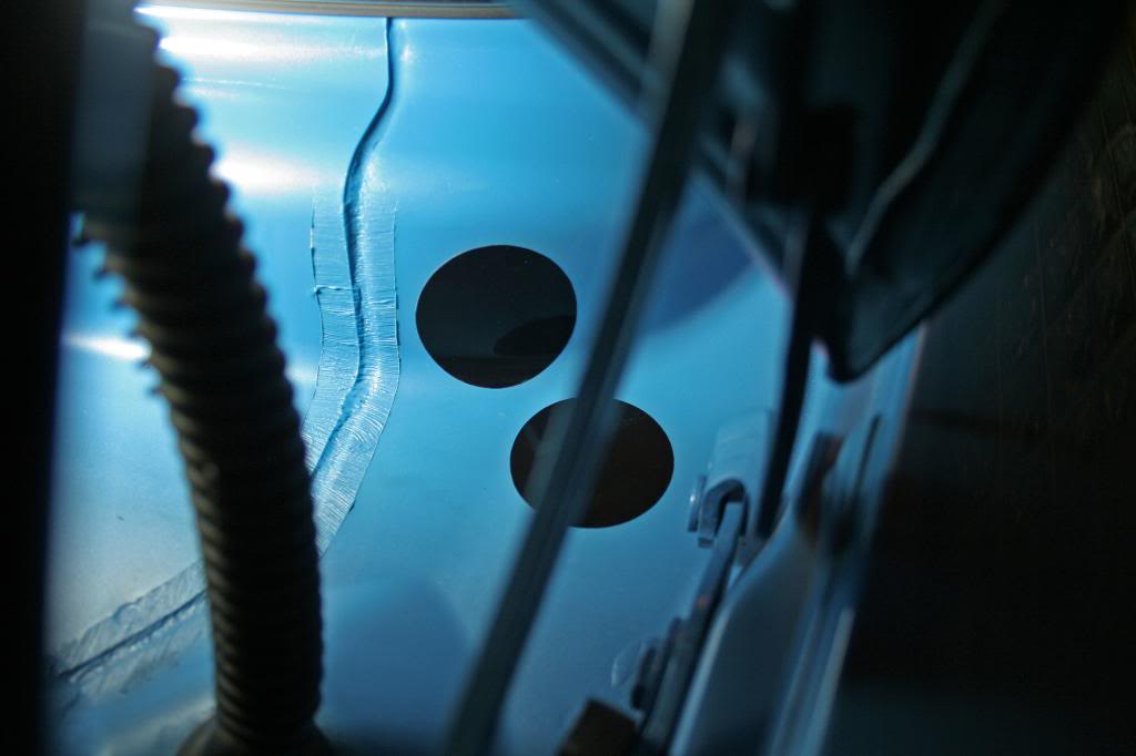

I had the paint loss from the snake cable and the grounding wire. They fixed that, too.

That's what I did with mine with some extra high-end vinyl I had. It smooth so it lets the cable come in contact without much rubbing.
It was easier for me than having to take it to the dealer. We'll see how it fairs:
