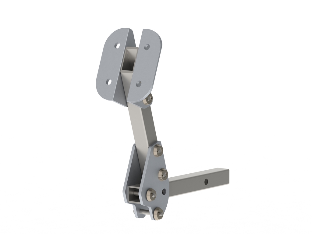

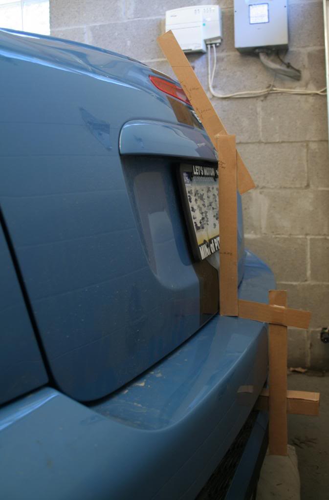

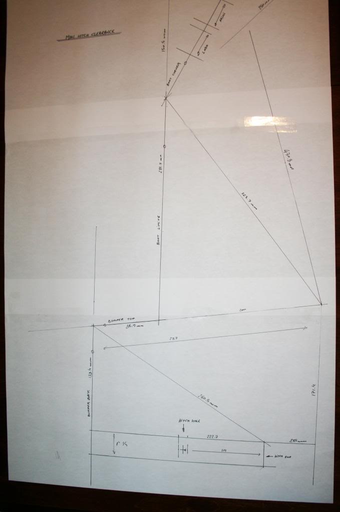

Okay, despite my hitch receiver end being crooked, which I'm waiting for some feedback from Outmotoring, I've started to take some measurement for the project. The intent being to create a dimensional prototype:
Old Apr 11, 2014 | 07:39 PM
  #68
TG.'s Avatar
TG.
Joined: Jun 2013
Posts: 1,614
Likes: 56
From: Western PA

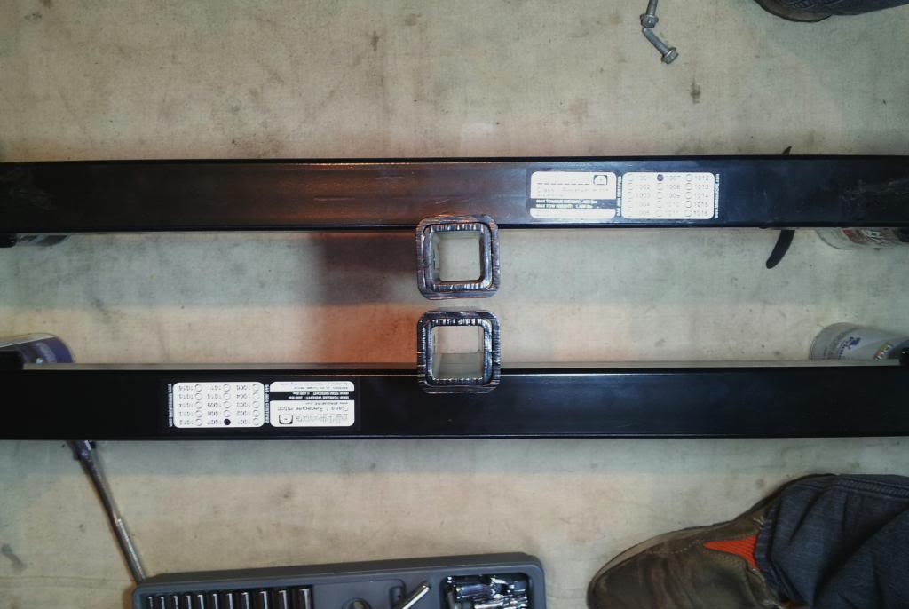

Okay, so I got the new hitch receiver today. Much better than the first one.
The install of the hitch receiver is now complete at it's great!
To top it off, and as planned, I fully concealed it cutting out the bumper just so when my custom cap is on you could not tell it is modified
I used some REN shape material and some special SEM epoxy I had on hand
And here is the comparison between the crooked hitch receiver and the new one. It actually worse than it looks on this photograph

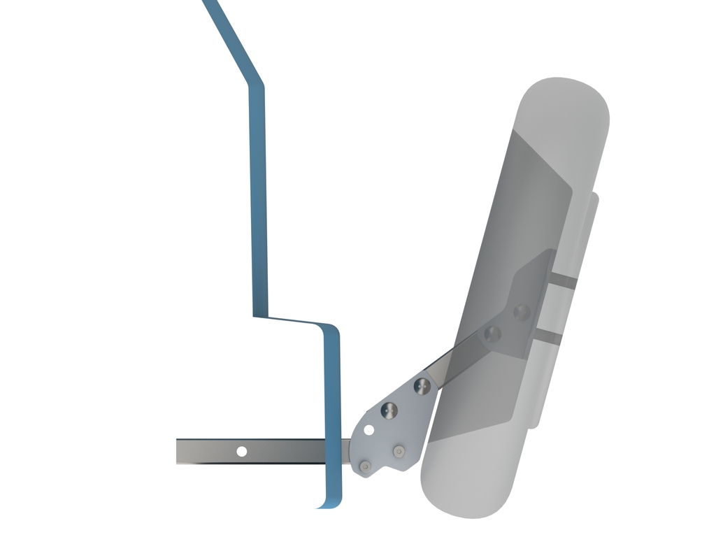

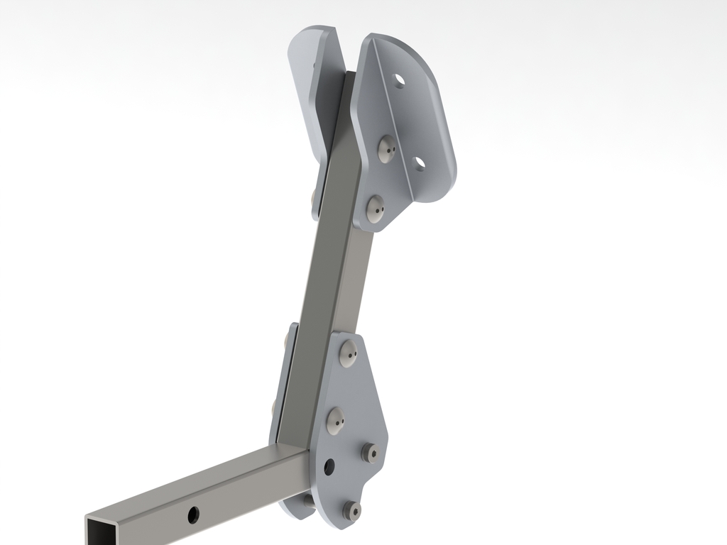

Now I've started to work on the project itself by placing pieces in CAD
