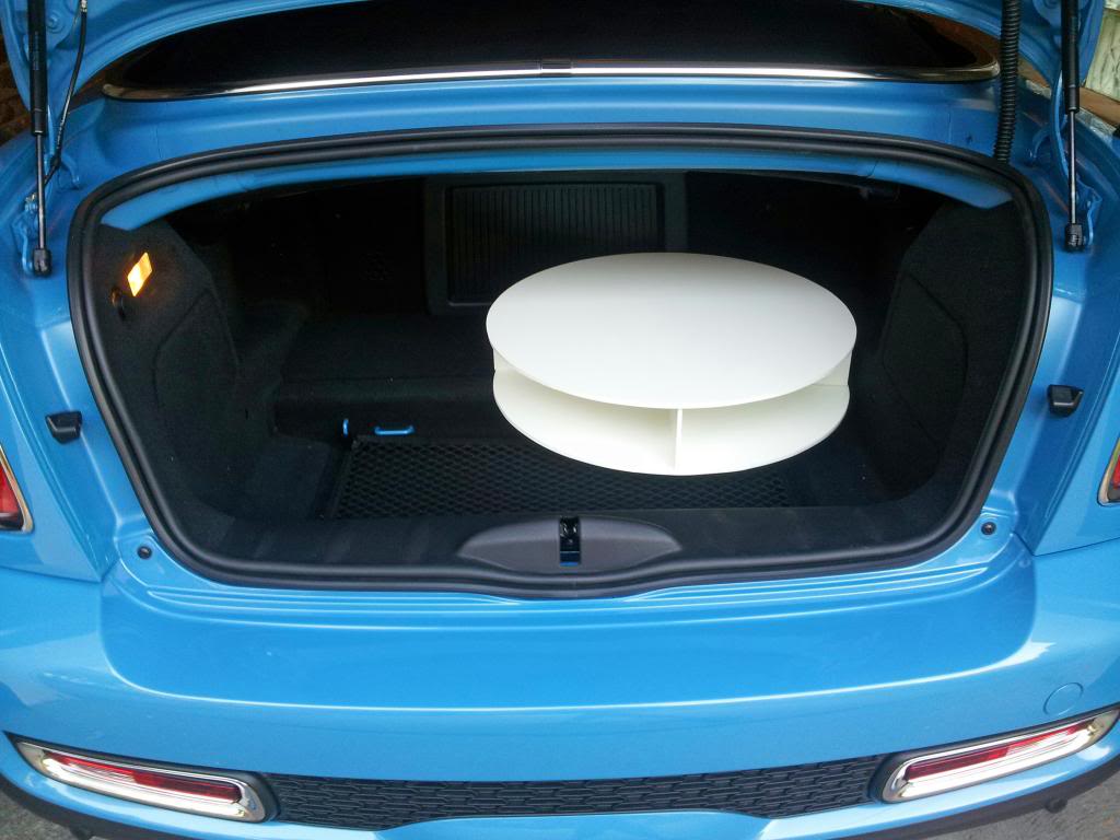

I made quick foam-core models to better understand the situation:
1:
2:
1) Obviously take a lot of space so it is not ideal for long trips as the trunk will get filled. Though I must say if fits okay. It would require planning when packing to insure we can get the spare wheel in. It is not my favorite options due to the suitcase packing needs. But for daily use could be a option.
2) It is an interesting option for long trips that I need to further access with my wife's comfort but it is not out of question. However it would require to be anchored to stay safe for sure in case of an accident. Also it would require to find a way to hold the flat tire+wheel in the rear some how...
I will still get a spare but it might be more to go help my wife when she's not too far than for trips.
For that I'm going to investigate further the rack options...
Not pretty but a big piece of mind on trips. If I would go that route in the long run I would definitely found way to make it more appealing one way or an other . . . I'm a product design so ideas are not what's lacking (more a matter of time)

I've made some time yesterday to investigate possible designs...
At the moment I have two approaches:
A - One possibility is to attach the spare tire to the boot lid itself. The approach would involve creating a bracket that would mount where the license plate is mounted. The design would involve a quick plate removal to attach the mount and place the plate over the spare. While this is the most compact solution with the cleanest integration there are three major hurtle to that design. 1. I might be awkward to release the trunk opening 2. It might be difficult to swing the door up and hold it up with all the weight 3. It might be more complicated to insure the proper strength is achieved to hold not only the spare but also the flat wheel.
Possible option is to allow for a quick release but that to might be a little awkward.
For all these reason this is not my favorite option, although I really would have prefer the way it would look.
B – The other possibility is to do a better version (less clunky) of the rear rack mount. My initial thought is to do so without requiring any modification of the rear bumper. Rather than mount a harness using the tug hole I would find a placement under the car to which I would attach it. This would make for a slim and potentially attractive design. There are sheet metal fold anchor points under the car that retains the exhaust. This is one area of attachment I’m looking into though I don’t know yet if it is ideal since I do not know the strength of that area. I’m looking at holding possible 80 or 100lbs to be on the safe side.
The advantage to this design is that I would make it to be a quick attachment so it could easily be mounted on the car for long trips and remove for daily driving. It also does not add weight to the door and possibly allow access to the trunk more conveniently.
In all cases I’m looking at design solutions that do not obstruct the rear backing light (at least when the spare is mounted), that allow easy access of the boot (I might investigate different ways to move the spare attachment out of the way), and that allow for quick relocation of the license plate.
Needless to say this is all very ambitious right now and I don’t know if I’ll get around to do it, but I thought I’d share my thoughts on the subject.
Part of me is excited to make something that would remain elegant and provide that old classic car rear mounted spare I think has some charm if done well. I’m also excited to optimize our roadster traveling space as much as possible.
If I do get going on this I'll let you guys have a pick at what I do. Who knows, there might be interested parties
