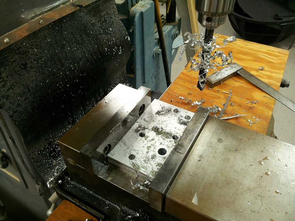

Old May 29, 2015 | 06:51 PM
  #78
TG.'s Avatar
TG.
Joined: Jun 2013
Posts: 1,614
Likes: 56
From: Western PA
Common, I need a little encouragement here
Finally got some time after work to start cutting the parts... it's going pretty well so far... if I can only find more time...
Oh and Designed and custom ordered a cover for the spare tire... that'll be the cherry on the cake

Old May 30, 2015 | 02:30 PM
  #79
komet155's Avatar
komet155
Joined: Feb 2012
Posts: 399
From: Exit 9
This is very impressive. Clearly you're a man with considerable skills on a mission! ;-)

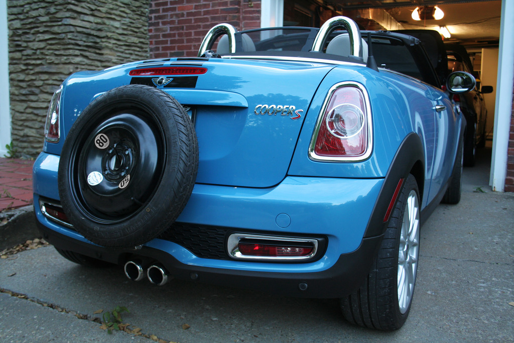

Old Jun 4, 2015 | 07:24 PM
  #88
TG.'s Avatar
TG.
Joined: Jun 2013
Posts: 1,614
Likes: 56
From: Western PA
Okay!..... first test fit...!!!!

Old Jun 5, 2015 | 01:33 AM

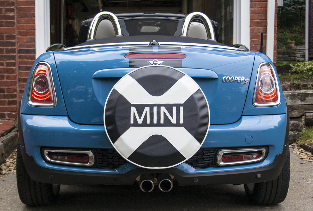

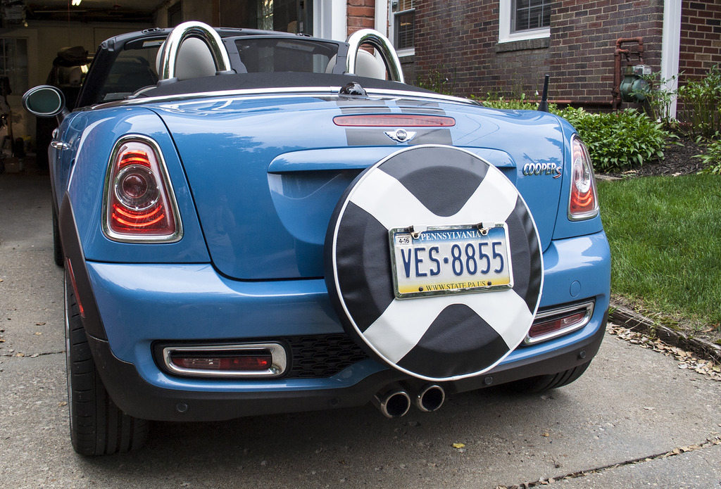

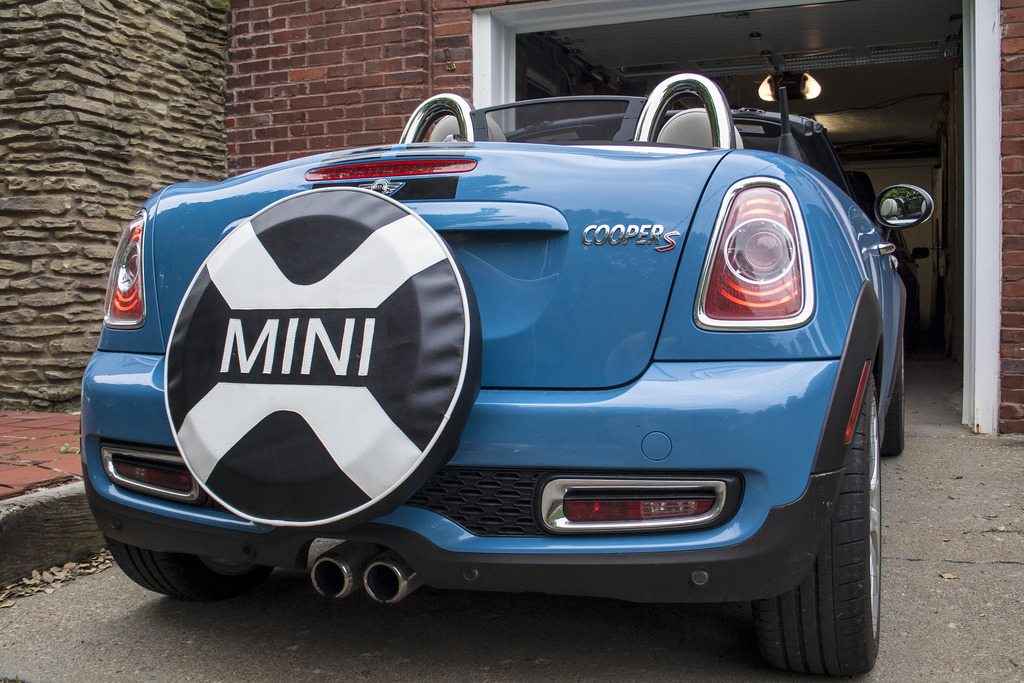

Okay.... it's done . . . just in time for our 3,000 miles road trip!
For show, without license plate:
For driving legally, with license plate:
