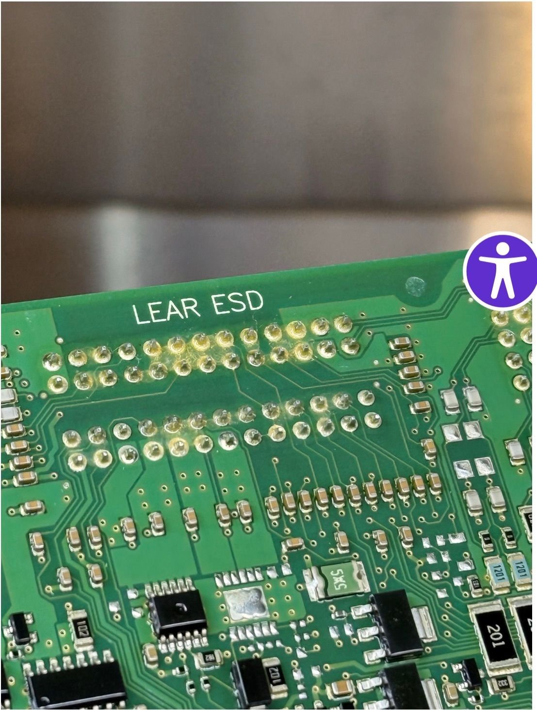

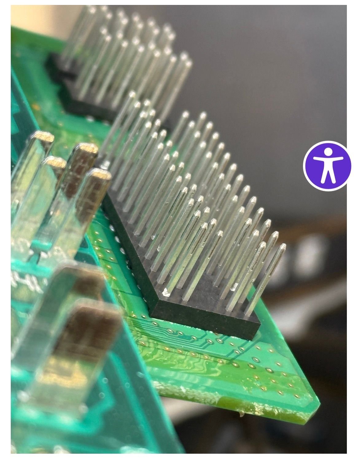

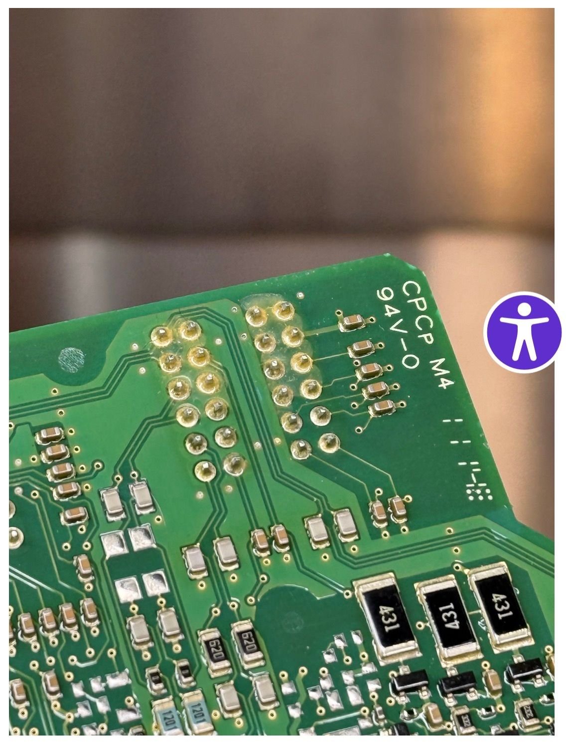

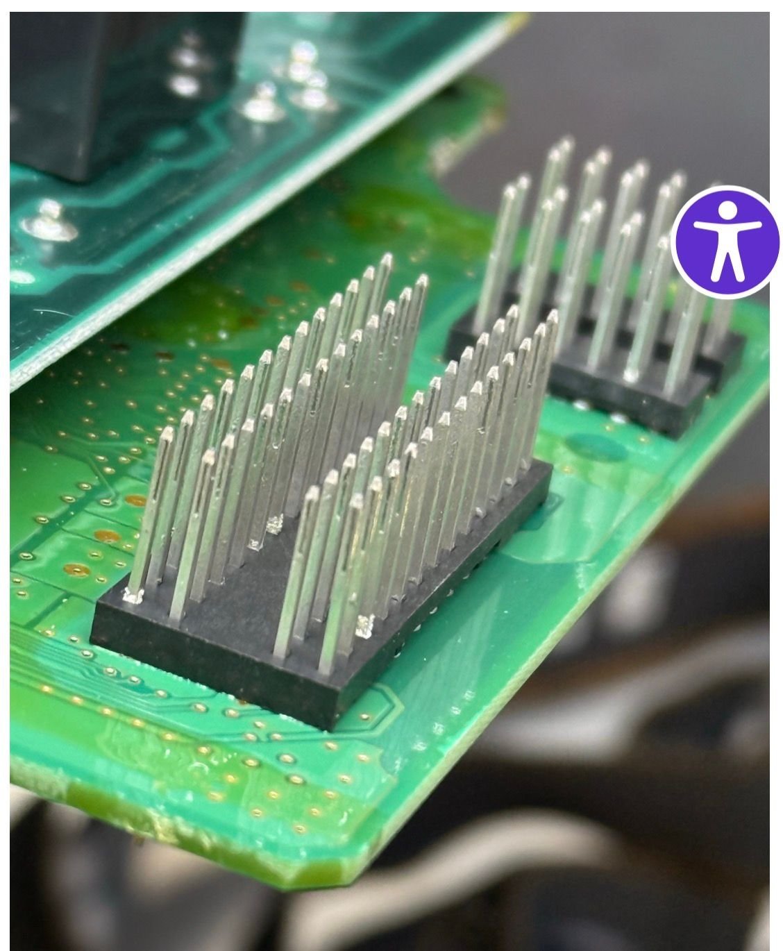

I feel the pain
Water is a constant in the R58
I’ve corrected the water ingress into the hatch area via the taillights
but
my vehicle spent 12 years outside in a wet Canadian climate there was a lot of water ingress both the driver and passenger footwell
Consequence of excess water I now need to replace JBE and CAS
It started with an intermittent key fob or CAS locking issue, suspected Footwell module but that part is fine.
I luv this little car but it’s certainly becoming a passion project
