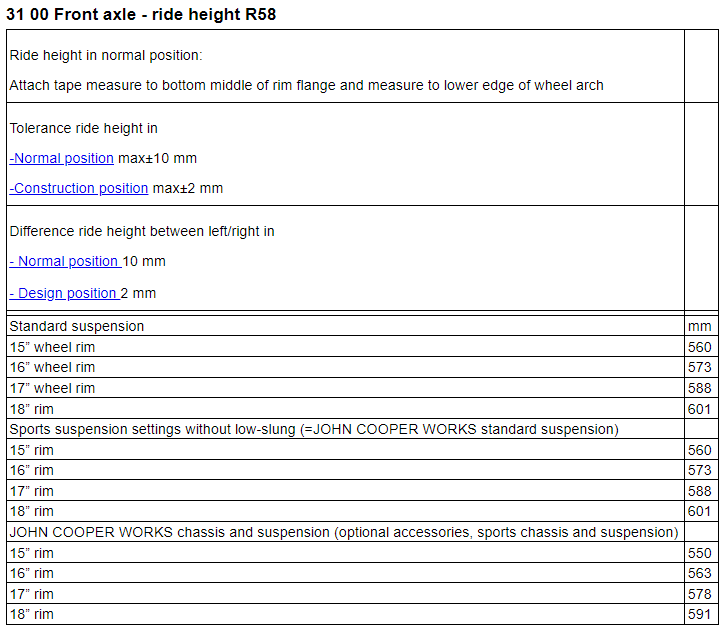

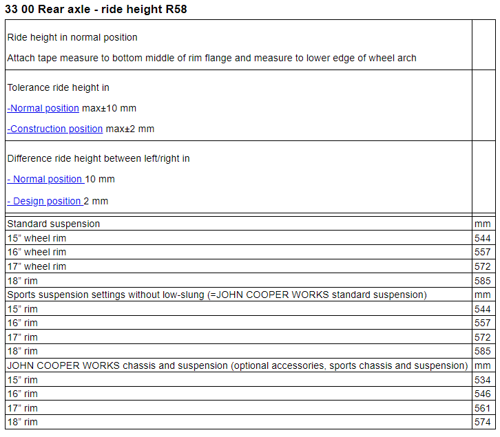

Here are the specs for the R58 ride height. You could go measure before swapping out parts to see how it compares to the OEM height.
How did you find this? I was looking everywhere for the ride height. I have owned many R56 JCW Coopers and I was trying to determine if those were higher or lower than the R58.
What is “low-slung?” I think I need to find the JCW suspension that is in the middle of the standard and the optional JCW.

I am under the impression that the "Low Slung" suspension is the JCW red springs. You can see from the specs that the "Low Slung" suspension drops the car by about 10mm. If your car has the EOM black springs installed, yours would be the "John Cooper Works Standard Suspension" specs.
Those are from the newTIS site. I can send you a PM with instructions for access.

That link worked great. Thanks again.
