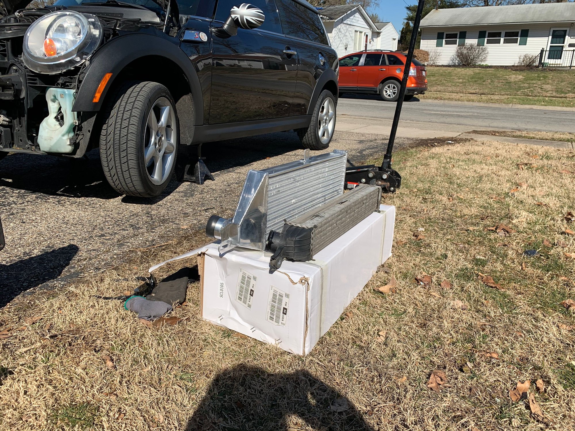

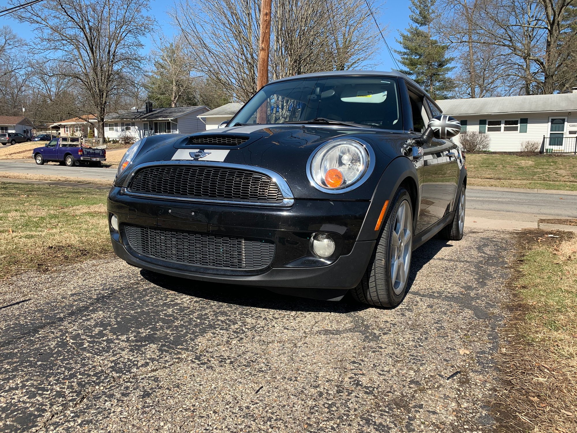

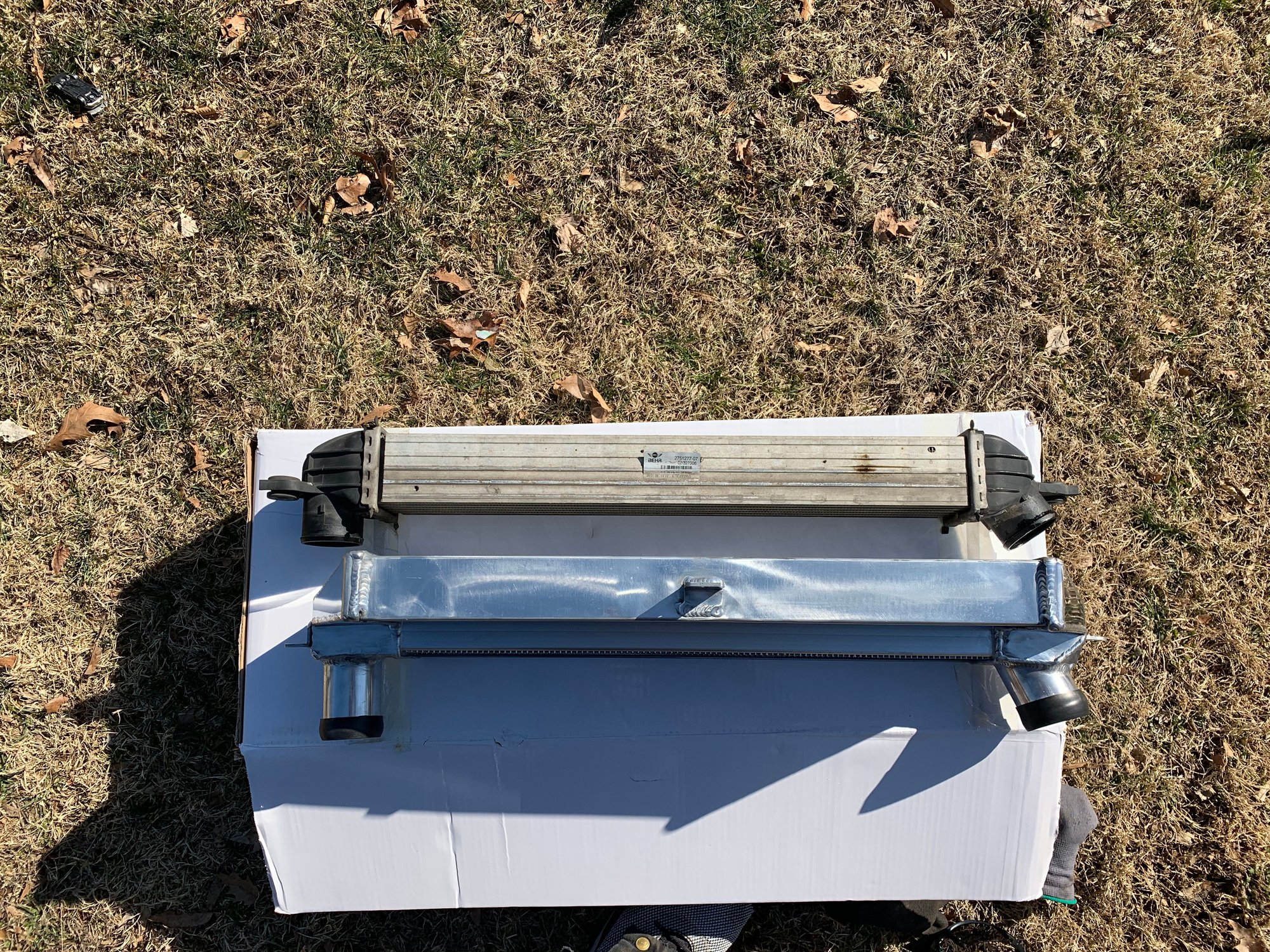

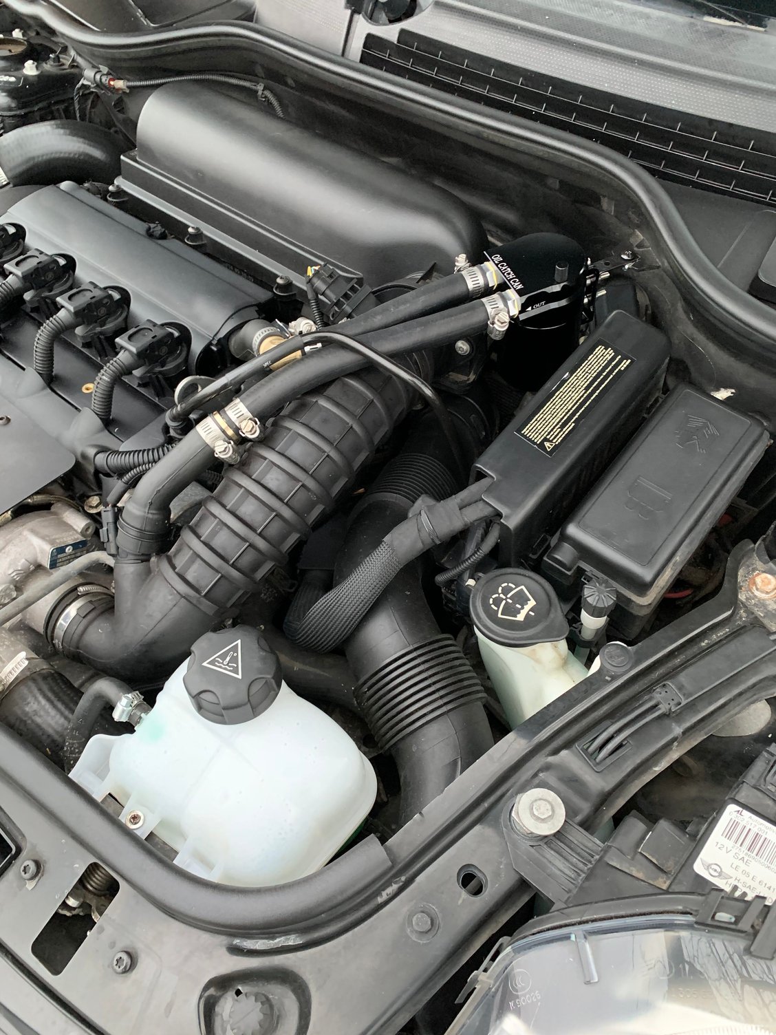

Not the best pic, but if your valve cover looks like this with exposed spark plug wires, then you have the n14.
I had to move the outside air temp sensor, zip tied behind the fog light. I have an 09, don’t have the extra crash bar. Had to cut the holes a bit bigger, on both sides, at inlet and outlet, it’s plastic so was easy to do. The grill has tabs, that stick out and the one held outside air temp, you could trim off, I spread them out and bumper fit back after a try or two. It’s a g plus, intake temps are 6 to 8 degrees above outside temp. Hope it helps.
