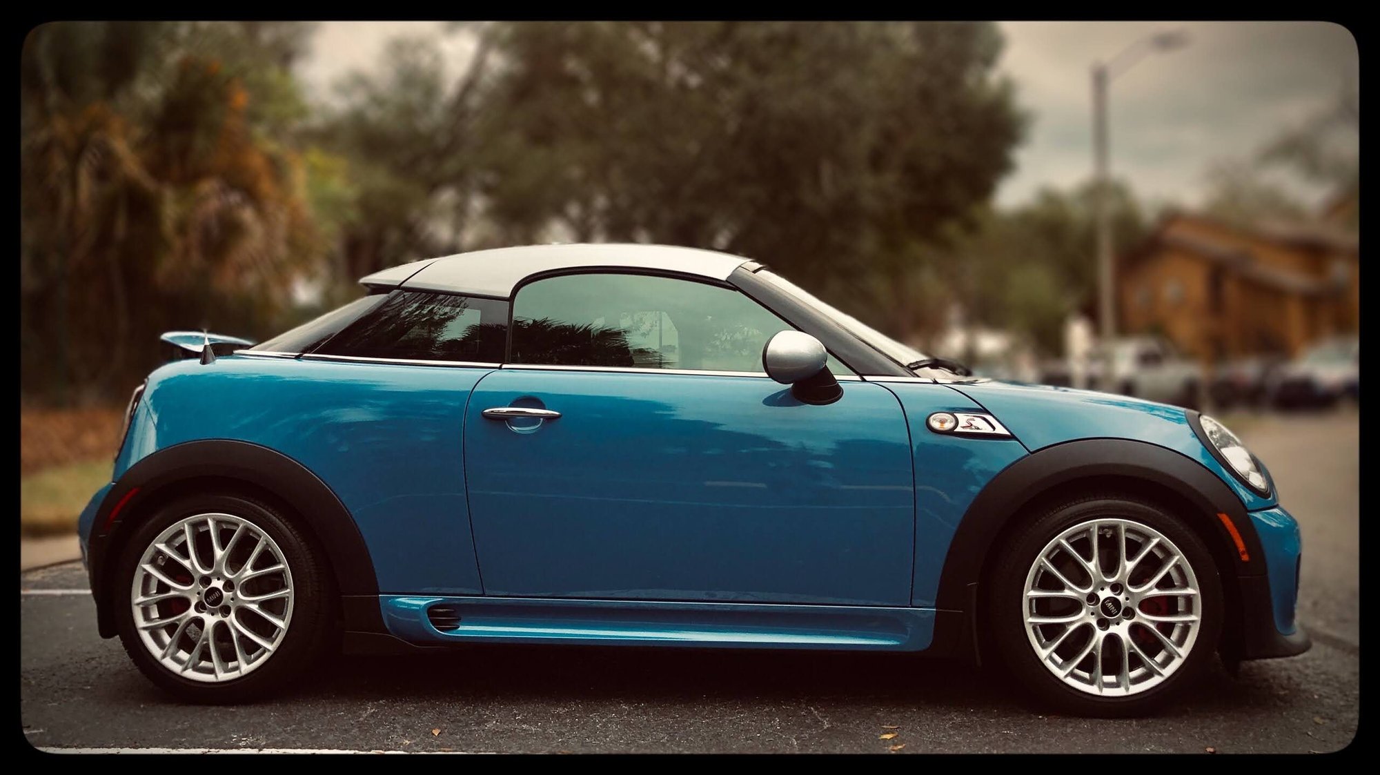

Hi NAM family!
I had a question. This past ending of January 2022 my husband purchased for me an R58 Mini Coupe S and I love it. It was garaged kept and has ultra low miles (23,500 miles) in mint condition. It’s such a fun and feels to have the potential of being an outstanding handling car. He just purchased a set of NM Engineering lowering springs and an NM 22mm rear sway bar.

Hello Iris,
I'm a "Blue Guy" and love the color of your car. However, it looks like the shade of Blue could be "off" just a bit from stock?
I'm betting this is Kite Blue...which I love. Can you verify?

Kite Blue is what it is. I was going to buy one before i bought mine.

Thanks for the response. Nice car and yes...I'm a Kite Blue fan.
PS: If you ever decide to sell please contact me.
