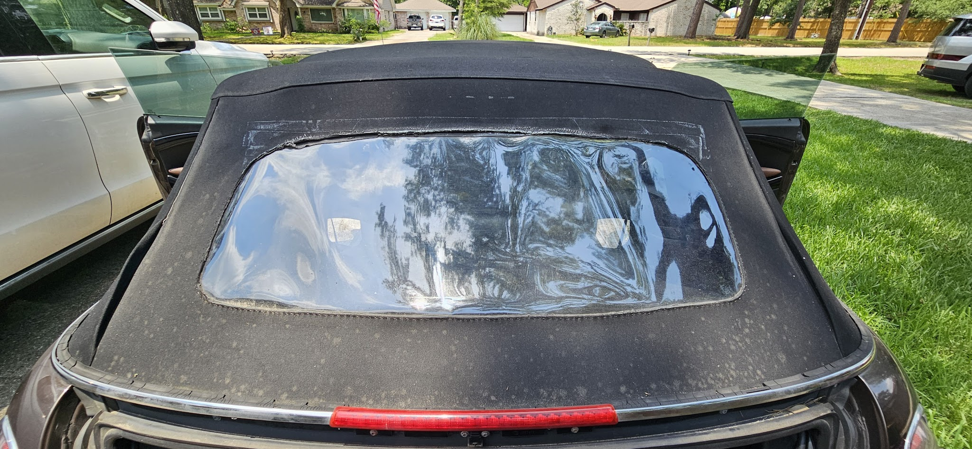

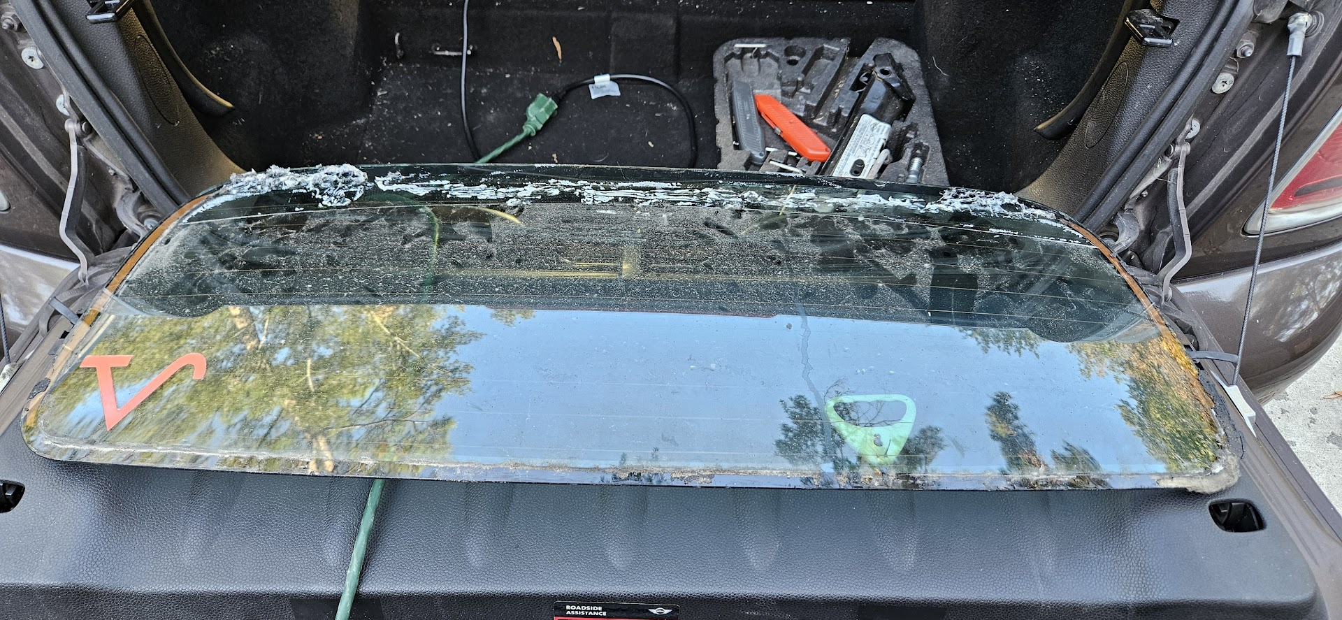

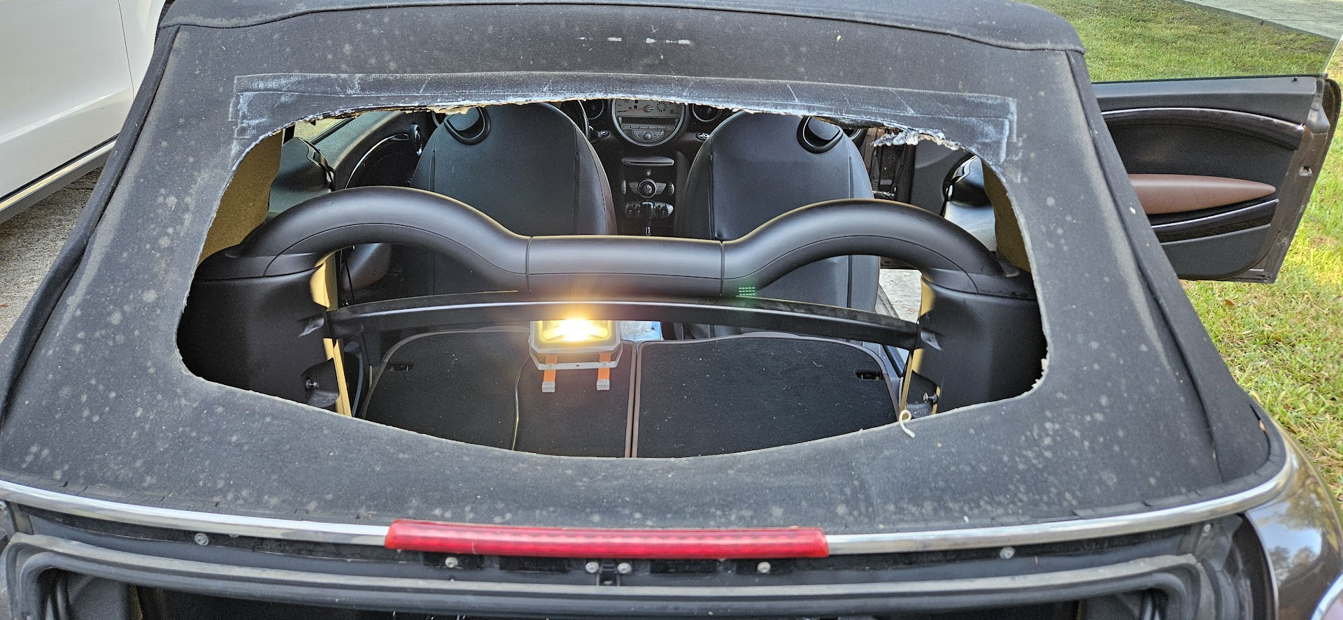

Started on it today. Removing the glass was surprisingly easy. Cleaned up the Lexel sealant I'd used to attempt to reseal the glass.
Strip of the strongest Gorilla Tape & set the vinyl window in.
took about 4 hours to stitch the top edge of the window, a lot of climbing in & out.
Its not quite as tight as I'd like it to be, but for a solo DIY, it'snot bad.
Sides & bottom should be easier as it should be doable from the outside.
Pushing a heavy gauge needle through 2 layers of top fabric and the vinyl is a lot of work to do over & over.
Hoping I can make some progress on it tomorrow & that I don't have a ton of pinhole leaks, but I can chase the inside with a sealant if that's the case.

Didn't get to work on it yesterday, but luckily, the Gorilla Tape is holding it in place well. No issues at 75mph on the highway this morning.
Only have about 80% of the top border stitched in so far. Need to work on it bit by bit over the next few days.

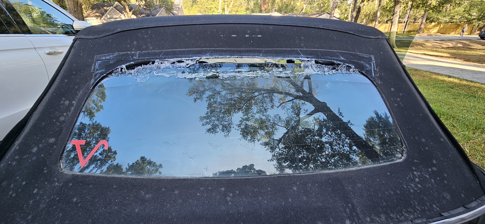

How it started, when I brough the car home, disregard the old glue, that was from the attempts to re-bond the glass to the fabric.
Temporarily, some black Gorilla Duct Tape was keeping it from leaking [heavily] in the rain. Just had a small drip at the top corners. Ugly, but it's worked for the time being.
The glass was shockingly easy to remove. Took a bit of time to clean up the fabric seam where it's attached.

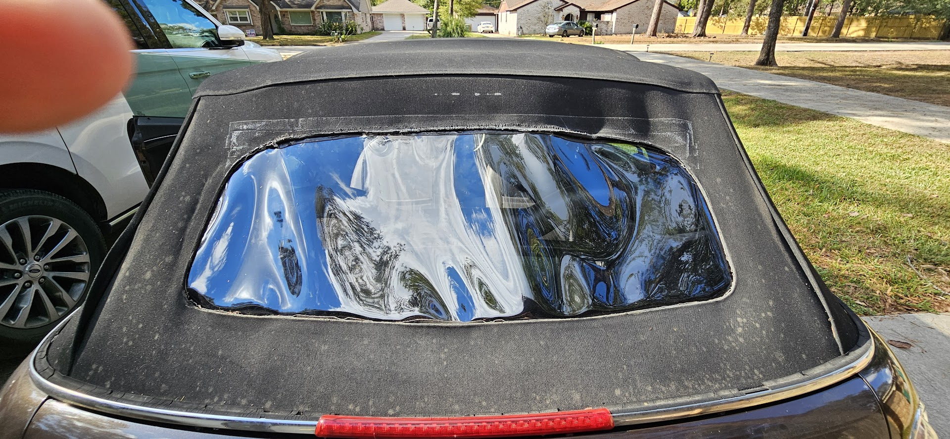

Vinyl window has a bit of a wave to it, hard to get it really tight solo. Hoping I can pull it a bit tighter as I get to stitching in the bottom & sides.
The vinyl I ordered came with enough that I could re-do this 2 more times [hopefully not].
Worst case, I'm out $50 & 6 hours [so far] on it. Better than the $2k & 10 hrs a new top was going to be [DIY]

Got the bottom edge of the window sewn up. Bonus, it's pulling some of the slack out of the vinyl.
Planning to run a bead of sealant once I get the sides done.

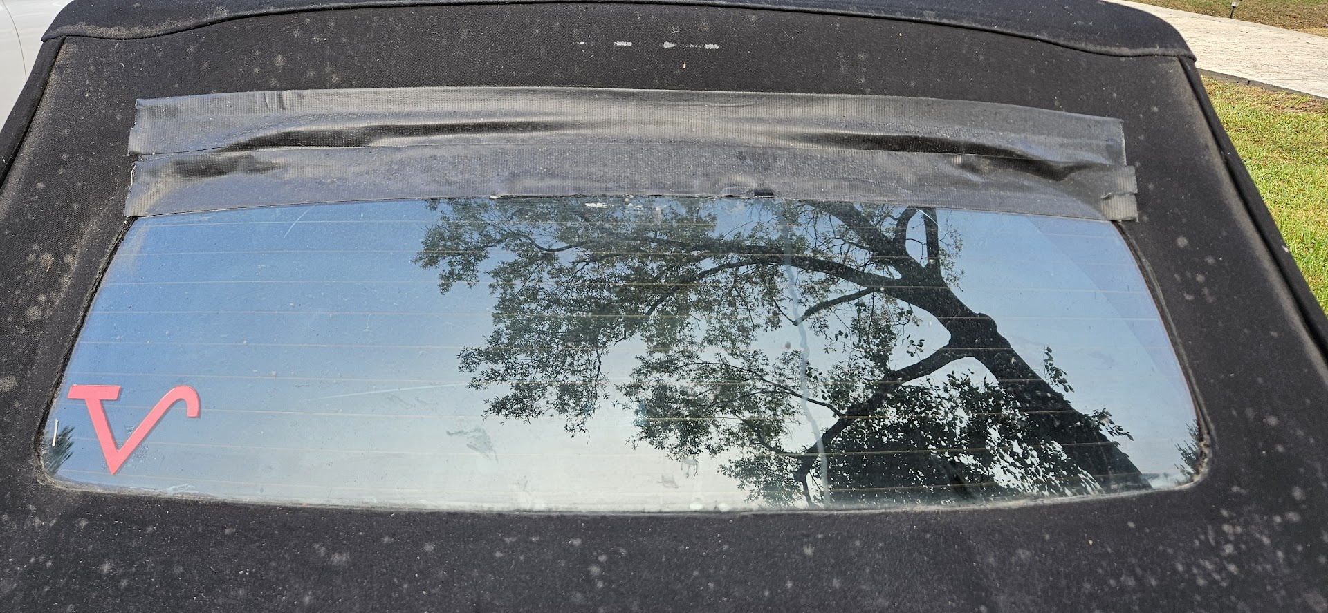

Finally buttoned this up completely. Haven't had the time & the weather wasn't cooperative when I did.
The tape was starting to fail at the top right, and Saturday was a free day [though hot]
Finished stitching in the parts I hadn't completed. Also pulled some of the wave out of the vinyl, which was a bonus
Noticed the seam at the top left had failed as well [guessing this was just bonded]
Applied another strip of the gorilla tape, and double stitched it back together
Sprayed it down pretty heavily & no leaks.

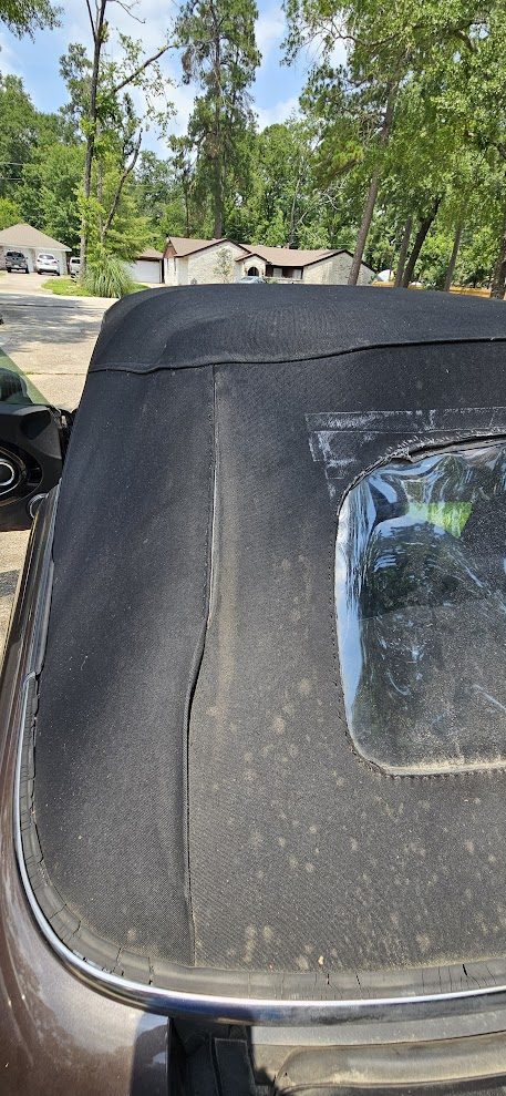

Did notice that the side support at the body line, on the driver's side, has failed. Project for another day.
