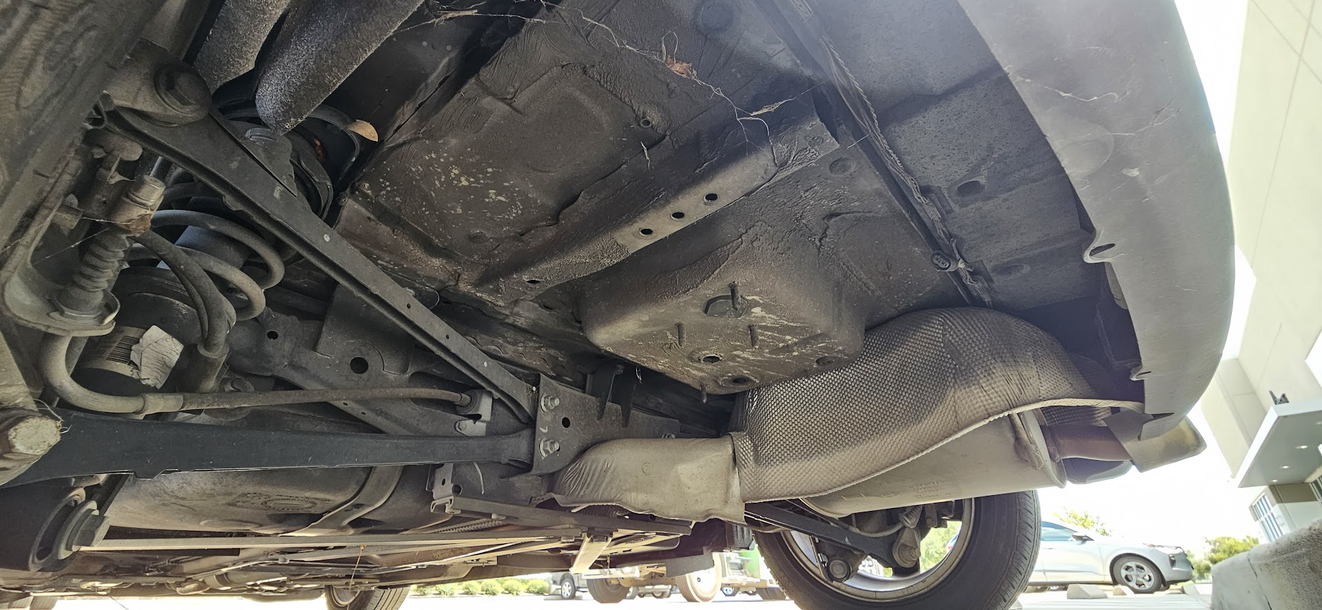

Old Sep 20, 2024 | 11:11 AM
JAMADOR's Avatar
JAMADOR
Joined: Mar 2024
Posts: 372
Likes: 72
From: Houston, TX
Here's the spare cavity.
Just those 4 studs on the bottom of the toolkit cavity in the trunk, and the square-ish plug/cover.
Drain plug is removed to allow water egress with the still [less] leaky rear window.
Old Sep 20, 2024 | 11:21 AM
Posts: 36,723
Likes: 2,537
Werid its not there, just checked your VIN and not on the sheet? Maybe because the stock tire might have been normal and not runflats?
You can always all all that stuff. Body is the same as the ones with it.
