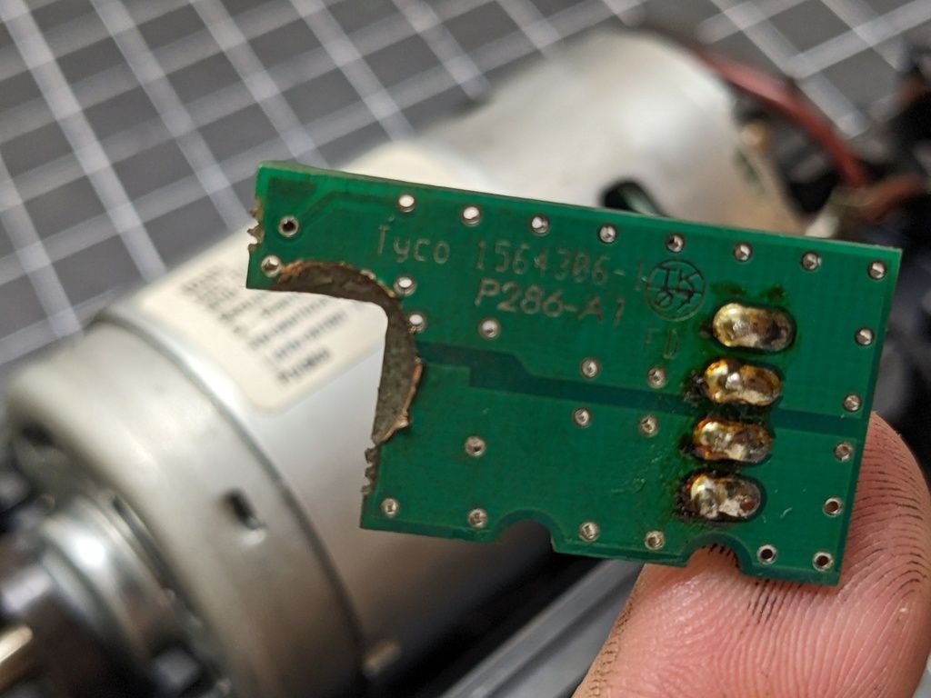

Last few days, my sunroof top would not close all the way, and when stowing the convertible top all the way down, it would not lock. You'll note that when stowing the top, the sunroof slides forward at the very end of the sequence to lock into position, so those two problems likely have the same cause. Eventuall, the top would not operate at all and when I tried to open it, I would get the convertible top error on the display. I checked all the microswitches in the boot area and they were all good.
I was able to pull codes using ISTA, cleared them and the one that came back was A98A, "incremental sensor, folding roof, direction". The "incremental sensor" is a small PCB inside the motor assembly that senses the direction of rotation of the motor using two hall effect sensors and a magnetic disc. I removed and disassembled the motor and found that the worm gear had walked down the shaft and gouged out the sensor board. I'm not entirely sure how this happened, but if you were to continue to drive the motor while the roof was all the way open or all the way closed and the worm gear was not secure on the shaft, it could walk.
In any case, if your sunroof does not move at all, this may be your culprit. I'm grabbing a used motor assembly, but I may see if I can get design a replacement increment sensor board and get it printed. It should not be too expensive.
