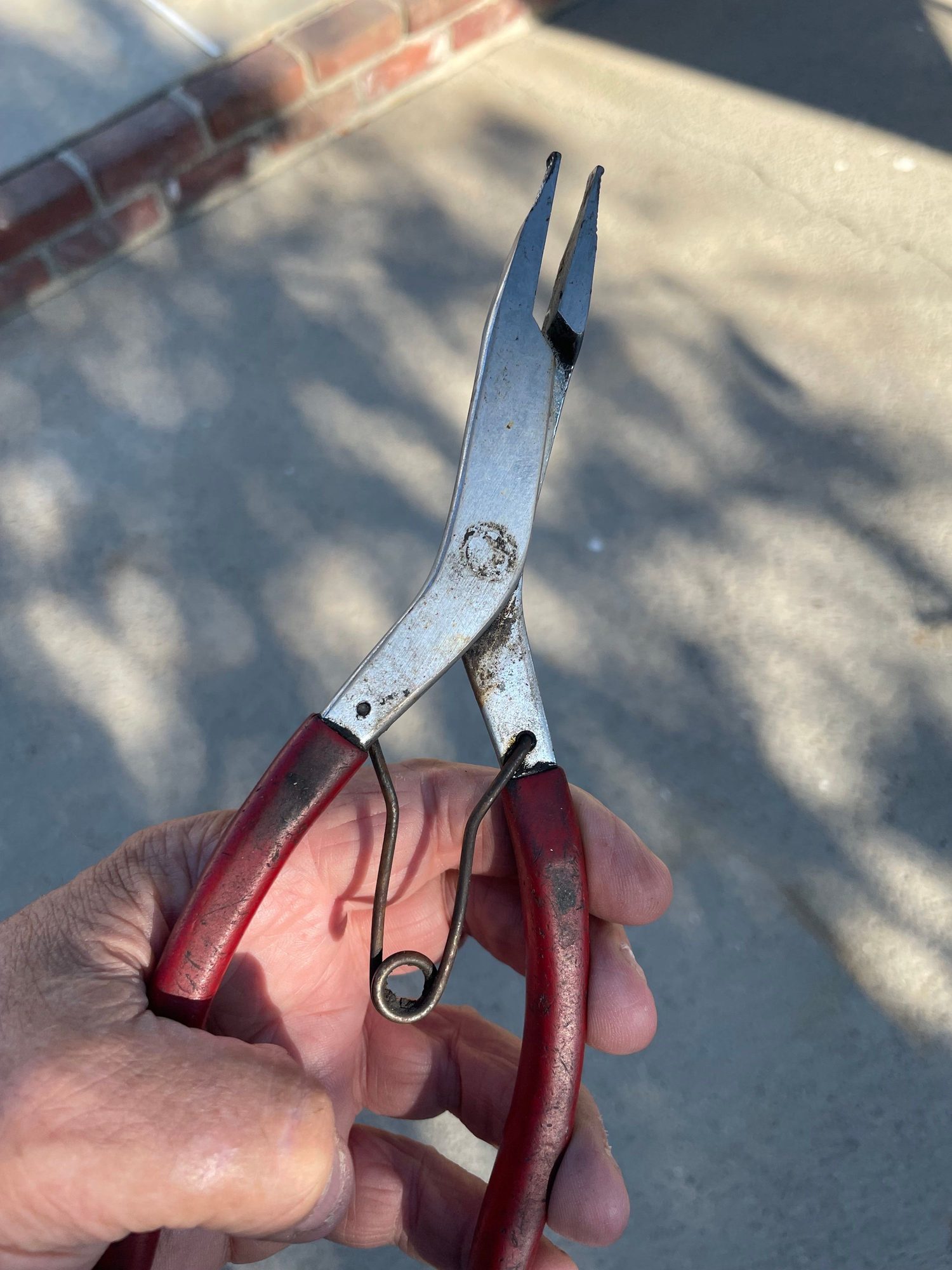

Is it possible to remove the front exhaust clamp without a special tool. I saw in a video a pair of pliers that instead of contracting when squeezed expands but i cant find one in any stores in LA wondering how else its done then

Reverse pliers.
also known as bow opening pliers.
amazon or harbor freight.
where in LA are you.

Im in bh, i went to Harbor Freight earlier but i didnt know the name of tool so i went to automotive and just looked for something that reminded me of it but didnt see it. Let me try that name.

Is it the long ring pliers?
Yes, the long pliers, that is what I used to open and install the olive connector.

Remove the bolt, and use the reverse pliers to spread the clamp.

Perfect, thank you.
