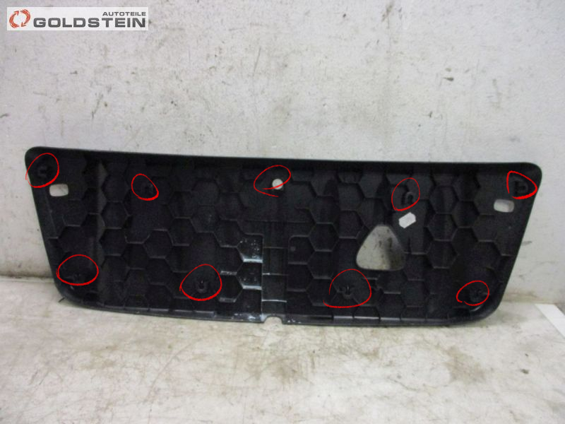

Before I try prying this off blindly, does anyone have pictures? Or at the very least, can someone tell me whether it's all clips or if there are screws? Coming from an R56 where I've done it before, but I haven't been able to find instructions for the R57.

Did it! Was all clips, but you have to have a pretty sturdy trim puller.
Here's a image i found and all the clip locations.
