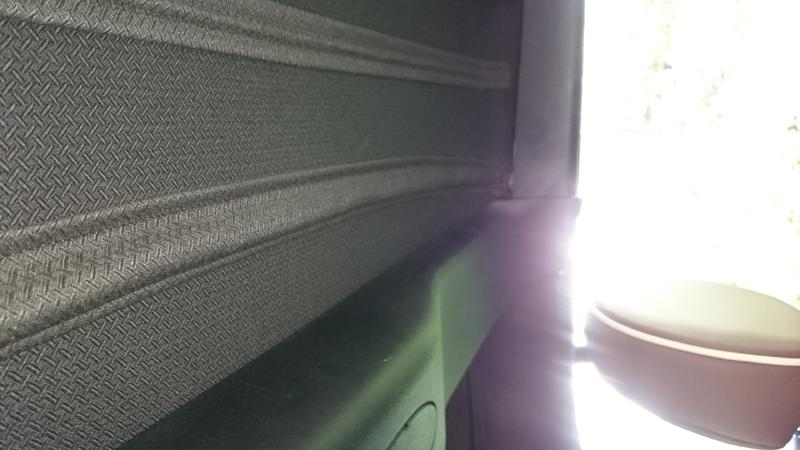

SO I though Id add a picture or two of the piece I mean to make it easier
Id also like to introduce you guys to my new lady, super stoked with her!
2009 Cabrio S with all the bells and whistles. Love her to bits

Looks to be the trim tray: 54342758084
Built in taps most of broke.
Trim Tray - Center
http://www.ecstuning.com/Search/SiteSearch/54342758084/
You should be able to snap the old one out and new one in.
Get some trim tools to help you , which are great to have for any trim/.
http://www.ecstuning.com/Search/SiteSearch/Schwaben_Trim/
