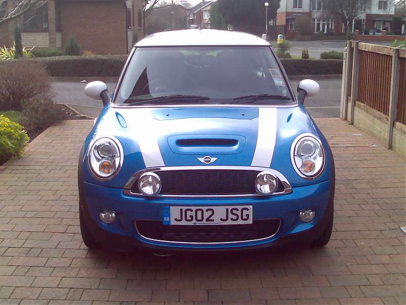

For those of you that are getting driving lamps installed:
-Do your dealers already have them in stock?
-The 2 colors offered: Black and Chrome -- Which do you prefer? Any pics to back up your decision?
-I've heard one NAM member that's said they work with the low beams. Can anyone confirm this?
-I've seen pictures where the bonnet stripes don't align with the driving lamps (see attached). Is the position of the driving lamps adjustable during installation?
-Lastly, did you notice that there are 3 parts to the driving lamp kit that have to be purchased -- at my dealer the driving lamps are $292, the install kit (incl. mounting brackets and pre-cut front grille) is $109, and the switch is $65 (or a colorline-matching one for $110). Grand total is $510 and that's not including installation!
Anyone have a picture of what the switch looks like? $110 for a switch means it must be a pretty damn good-looking switch!
Is this a DIY job?
Has anyone gotten a discount from their dealer on parts or labor?

Maybe the hood struts are replaced too, adding to the costs? I have the factory driving lights wired to the parking light circuit, but the they have such a focused beam that they bother alot of oncoming traffic.If I adjust them down they are just a big spot of light in front of the car. Maybe the truckers don't like the idea of a small car having bumper mounted lights on (trucker busy bodies) ,but I get alot of high beam flashing with the drivers on.

They call for new struts if you also have the xenon lights, as they are heavier - shouldn't apply to new cars though, as the lights are no longer part of the bonnet. FWIW, I just installed mine, and the hood stays up fine without new struts - though I'll be keeping an eye on it.
Aye aye aye! Driving lights are supposed to be wired to the high beams. They are NOT designed to be used when there is oncoming traffic, for the reason you state above. You're blinding oncoming drivers, which is both impolite and potentially dangerous.

+1, There is no difference between bombarding oncoming traffic with your driving lights & not dimming your highbeams. Plus it is illegal in many states to have driving lights wired to be on w/low beams
