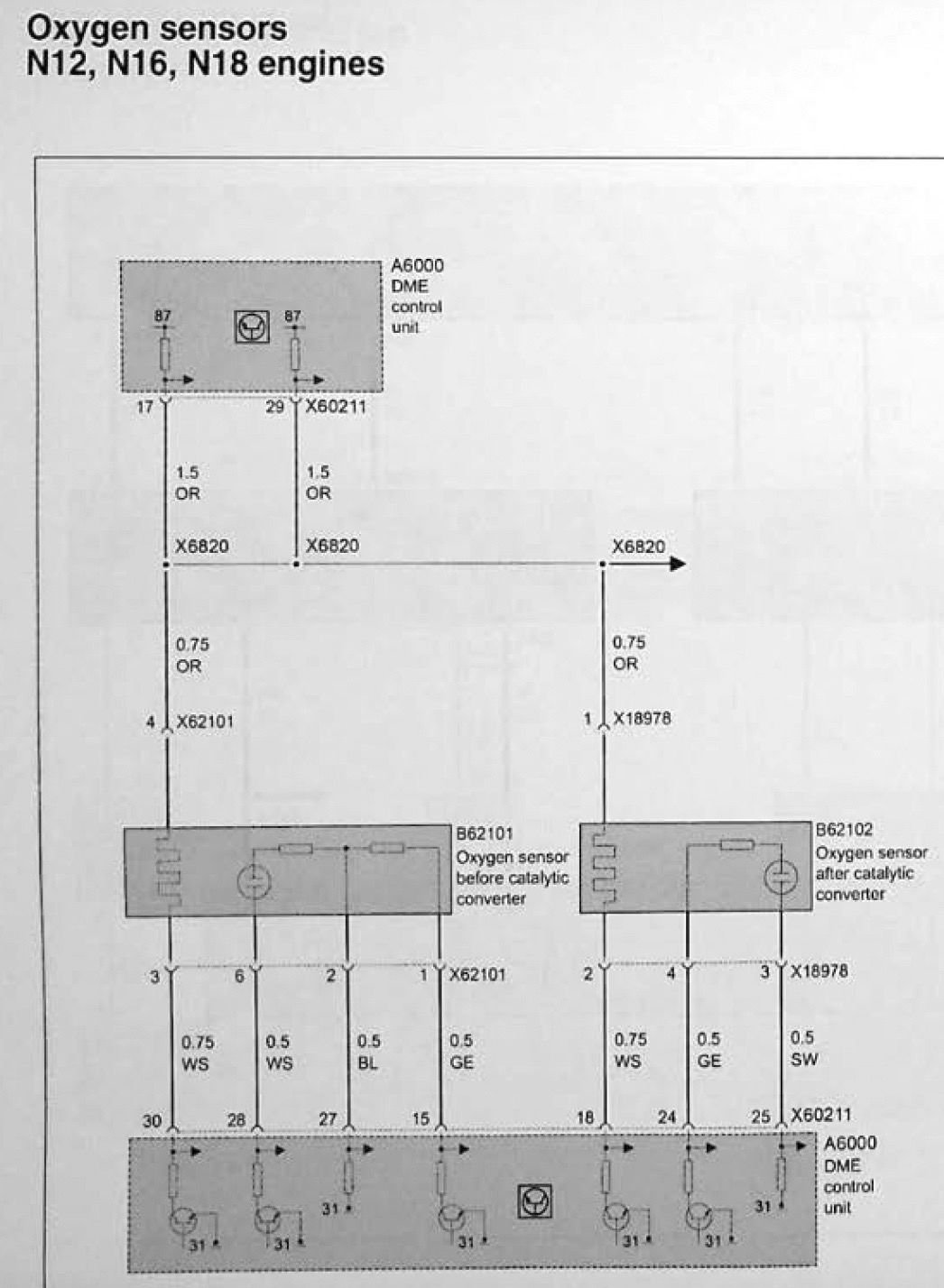

Good question. I can't think of a nearby 4-pin connector that can be swapped with the downstream O2 sensor connector. Just for verification, check whether the wire colors match the wire diagram (orange, white, yellow, black).
