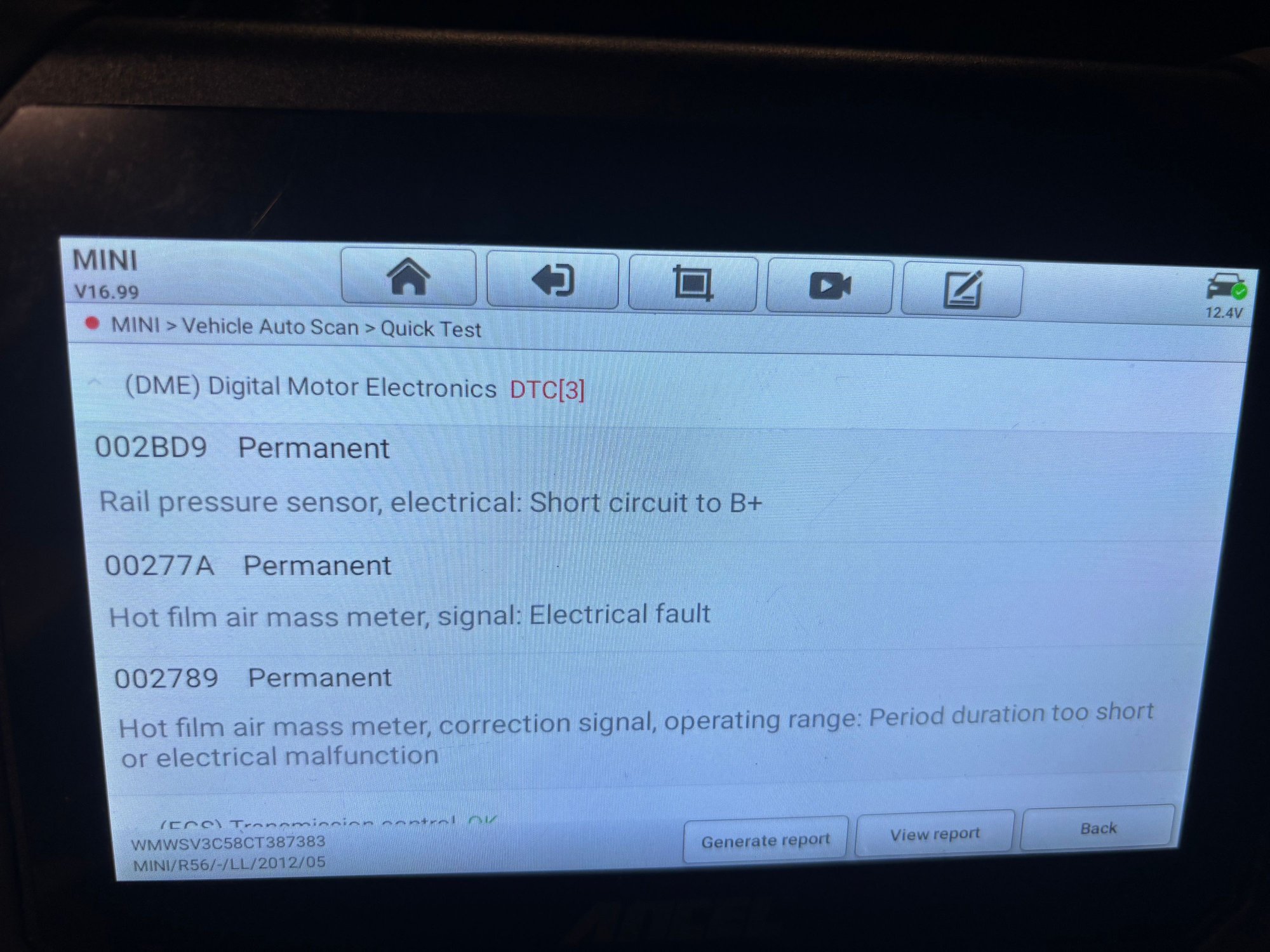

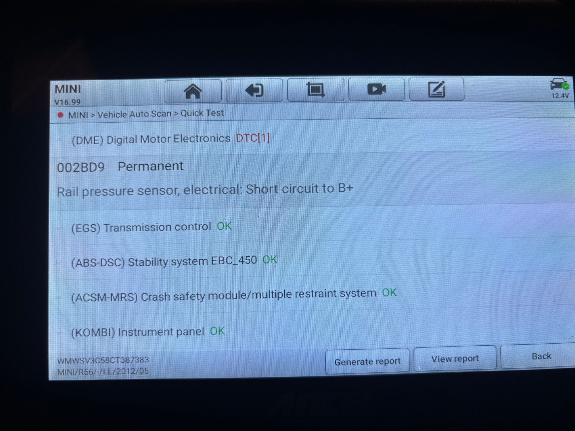

I bought a new H6 AGM battery from Costco. Registered the battery using scan tool hot function. Hoping I did it right. See pictures. After clearing codes, I got the short circuit B+ on the fuel rail pressure sensor only.
After following your directions with pressing on pedal and cranking for 5-7 seconds (I’m assuming I also needed to step on brake at same time to initiate crank). Then I released pedal and just stepped on brake to crank engine. It cranked with no start. mAF and fuel pressure gauge still not connected. Received 3 errors after scan related to MAF and fuel rail pressure. Anything else I should try? Thanks.
After clearing codes, this one came back.
After cranking engine, these 3 appeared.
