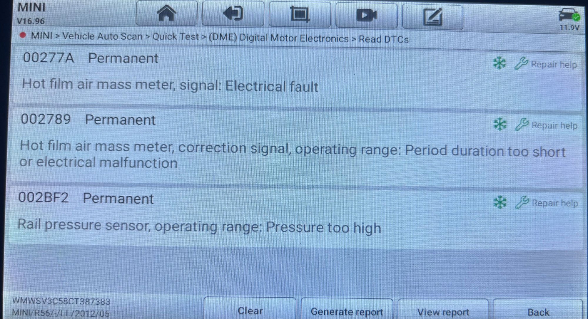

Seems like now I’m getting random errors.
Now getting this error about rail pressure.

Both the MAF sensor and fuel rail pressure sensor share the same DME 5V rail. When your DME was damaged, the abnormally high voltage present on this 5V DME rail may have damaged both sensors. Code 002BF2 is preventing the engine from starting.
Do this test:
1) Turn off the ignition and disconnect the (-) battery connector.
2) Unplug both sensors.
3) Reconnect (-) battery connector.
4) Charge battery to 12.6V, if necessary.
5) Try again to start the engine.
This test may be followed by a couple of voltage tests, depending on the results.

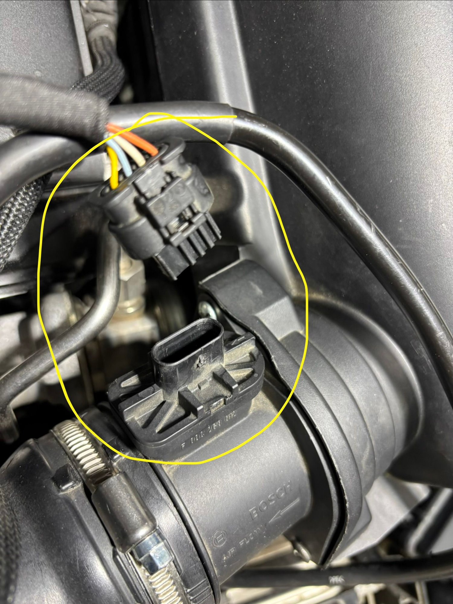

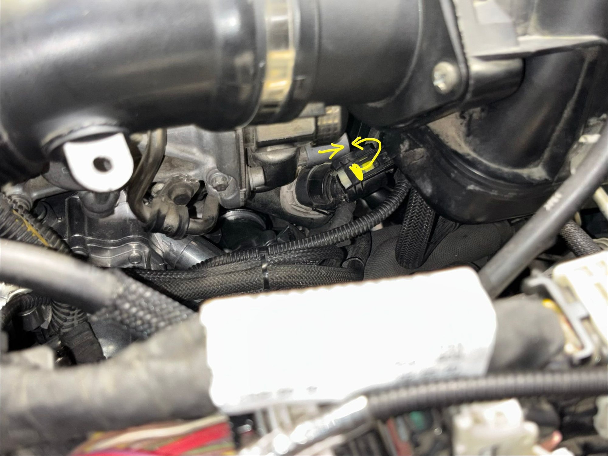

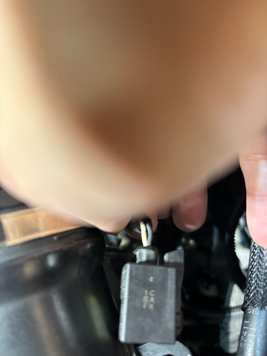

So I believe I connected the correct sensors. See pictures below. Reconnected (-) battery. Tried to start car without two sensors connected and same result. Engine cranks but won’t turnover. Then I checked and cleared ODB codes. Tried to start again and same result. Check scanner and got the same codes in the picture below.
Last set of codes.
Last set of codes.
HAM sensor disconnected.
Fuel rail pressure sensor disconnected.
Fuel rail pressure sensor.

Just for verification: The rail pressure sensor connector has three wires (Blue, Yellow, White), and the three codes you posted are present when the MAF and rail pressure sensors are disconnected?
Next test:
Does your scan tool read live data? If so, check whether you read between 150 and 300 rpm when cranking the engine.

I must have disconnected the wrong wire because this one only has two wires. I will try to find the correct sensor.
