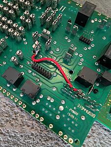

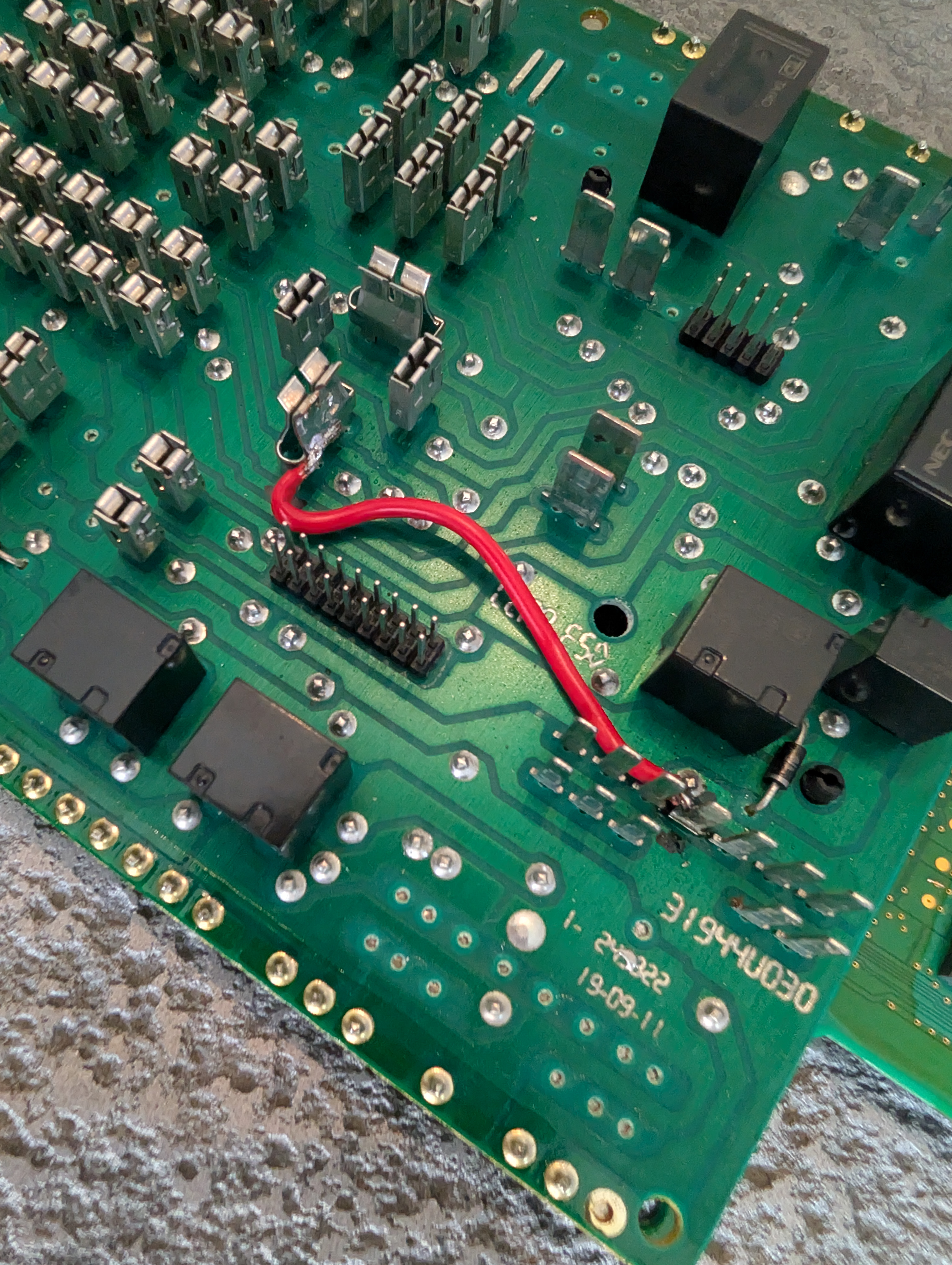

I just finished soldering wire between terminal 87 and pin 9, and the socket receives 12.6V - however, the fuel pump runs at all times even when the car is off. I could wire in a switch that lets me manually turn on and off the fuel pump, but the problem is that the car still won't even start. I figured if we got the pump running, the car would start. I am at such a loss of words right now...

Post clear pictures of the jumper wire installation and the solder joints. My initial wild guess is that some of your solder may be contacting a trace or component with constant battery voltage because terminal 87 gets voltage from fuse 46, which loses voltage with the key off.

In the picture, it might look like there's also contact with the pin next to pin 9, but only the insulation is touching at that point

You need to find the source for the unexpected voltage. Desolder the wire attached to pin 9. With the key off, does either pin 9 or terminal 87 still have voltage?
Does the K96 relay seat properly with the wire soldered to the terminal 87 socket.
