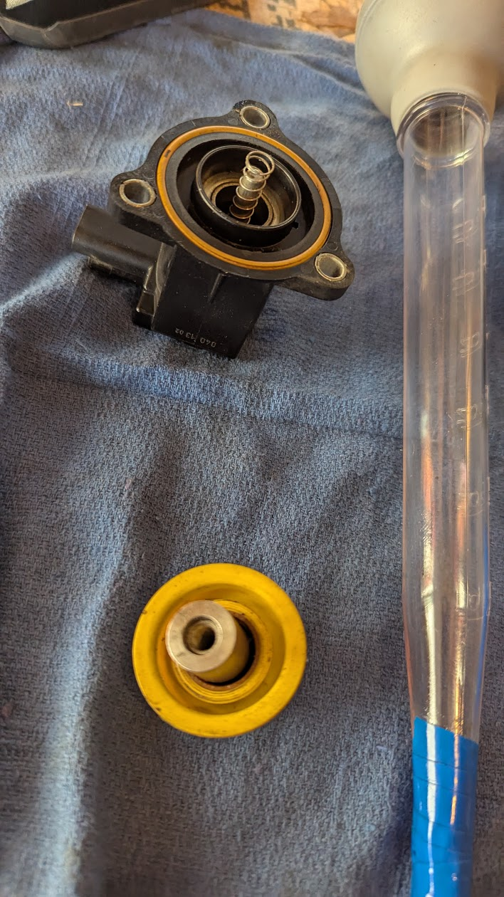

Installed the parts. Hissing sound is still there and it's not making full boost still. It feels like more power than before, but it's hard to judge. There's a bost leak somewhere else, looks like I gotta go hunting.
PCV membrane had several small tears in it and was filthy. Good to have it replaced.
Original valve (it came apart on its own like this when I removed it). This looks like the original revision that fails a lot, the one I installed looks quite different.
