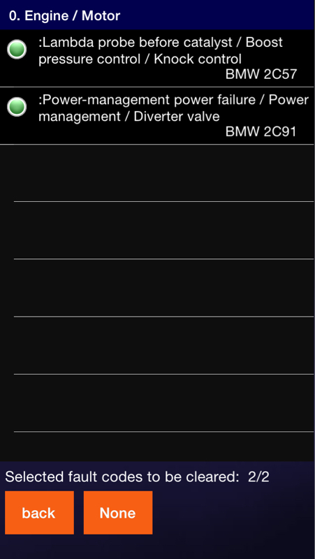

It was I. Still trying to hunt these two very frustrating codes! I thought it was the meth jet elbow but that was not it. Had both the high and low pressure fuel pumps replaced lately, thought that was it, no dice!
Attachment 103863
Are you still trying to figure out the low boost issue? Sorry the picture is blurry on my phone..
Old Dec 19, 2014 | 09:06 PM
wzabrouski's Avatar
wzabrouski
Joined: Jan 2008
Posts: 1,012
From: Keller, TX
Yep! 2C57 and 2C91
Yep! 2C57 and 2C91
How long have you been encountering problems? Don't those codes mean like failed/stuck diverter? Have you removed it or replaced it? Or not yet.
