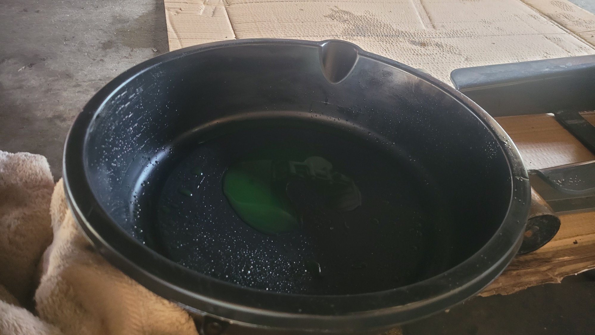

I've watched every video and read every. How to how the f*** do I get this PULLEY OUTTA here? I swear to God. There is not enough room no matter how hard I try it butts up against the frame and its back edge won't clear the f****** attachment on the water pump, it will not come out, I have tried everything. I've been at it for 3 f****** hours and on top of it. I Just spent twelve hours replacing all the coolant hoses and a bunch of other **** too only to find my ****ing water pump leaking as I came out the next day.
how do I get this goddamm thing OUT !!!!!
I love how project Minnie shows how to do it and says how to do it.But suddenly the camera cuts off and it's out so obviously that wasn't the way to do it or how to do it.So what is the trick?How do I get this d*** thing out?And how do I get that f****** tension off the third bolt, the top left one is impossible to get at.I've tried about 10 different f****** tools on that too.And I cannot get that piece of **** off either.

Even AFTER lowering my engine as far as it could ao that it would give more access and room I STILL couldn't get it out .
I ONLY got it out by hammering it from the top to wedge it out , now idk how on EARTH I'm going to get the new pulley onto the new pump..
Then my issue wasn't the pump , the coolant tube had cracked where it connects into the waterpump housing lolol after I did ALLLLLLL that work yesterday to fix the leaks.
Haha if not for bad luck , I'd have no luck.
So now i gotta figure a way to get it back together. I had a new ALUMINUM waterpump, coolant pipe and waterpump pulley overnighted because I need to get this done so I can blast my valves. And theeeeeen I get to do control arms and bushings , YEAAA.. LOL.
any tips how to get it in ? There was absolutely no way I could have pulled that pulley out , I swear I tried ATLEAST 2hr , then I just i finally whacked it out because i was pissed.
