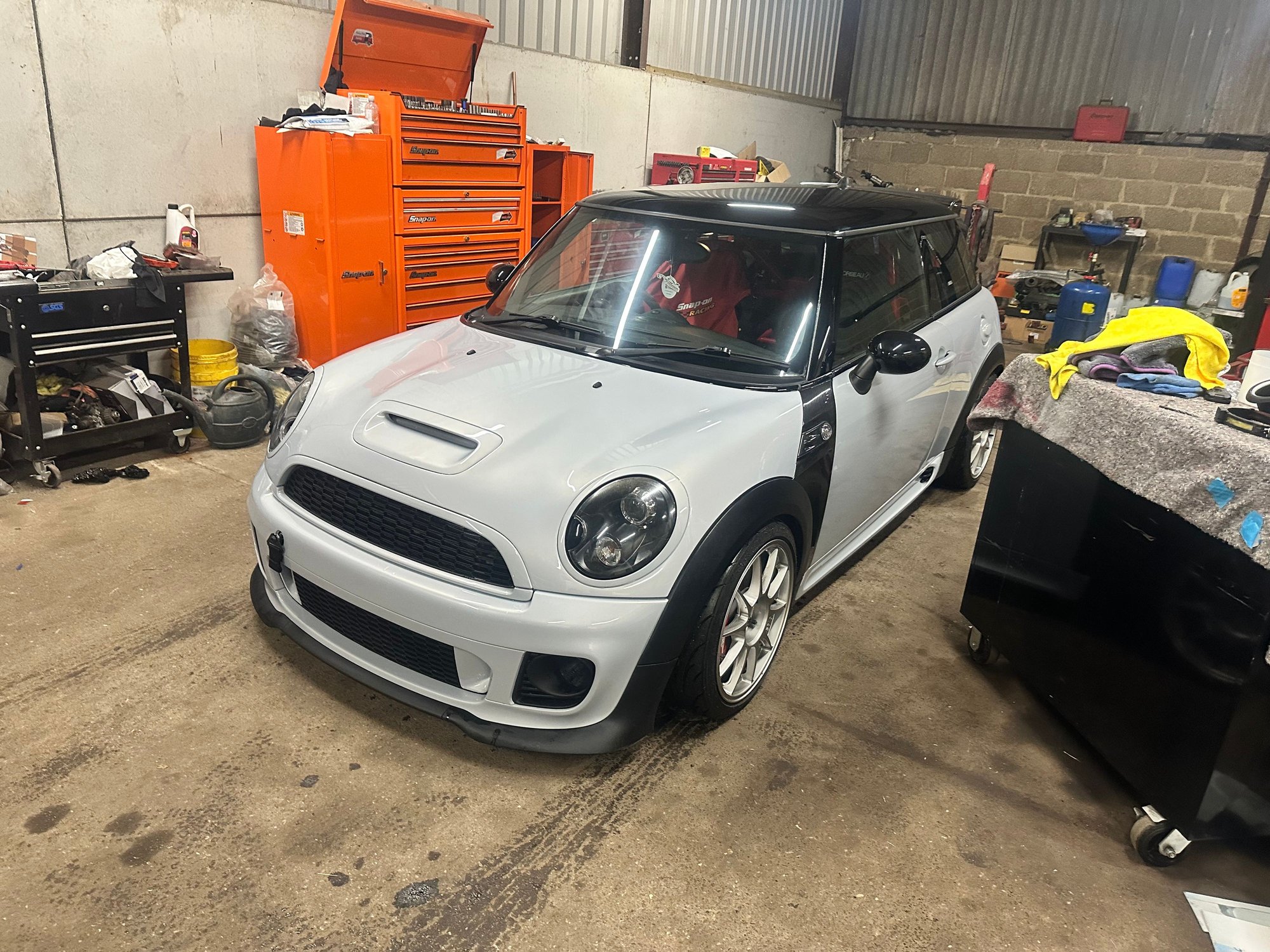

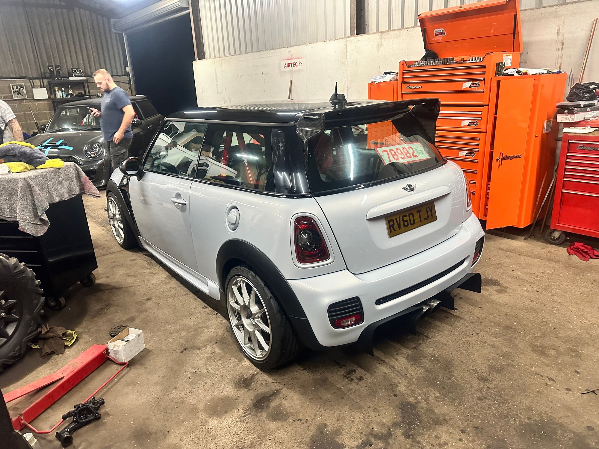

Hi all, New to this site so be gentle
I have been chasing a low fuel pressure fault for awhile now and struggling to get to the bottom of it
symptoms are coughing and spluttering at 4 1/2 thousand rpm
I have an ultra gauge fitted and I can see the rail pressure underload fluctuate between 1800 and around 300 psi
Sometimes it will rev all the way through the rev range until 6 1/2 7000RPM
Most of the time it costs and splutters at higher rpm
So far, I have tried a new low pressure fuel pump genuine used one I have also fitted a aem. 400 LPH fuel pump
I have replaced the high-pressure fuel pump with a known good one
I have removed the fuel filter housing replaced the filter and cleaned it
Replaced injectors with known good ones
I have had the foot well module part to check sold a joint on relay they looked good. I re-sold them anyway just to be sure
I really am struggling with this problem, it’s my track toy and we’re coming into some good weather now and I’m really want to get to the bottom of this problem
Any advice would be very grateful any point as you can give me anything I’ve missed please fire me over some information or pointers anything I need to look out for or anything I may have missed
Many thanks, Antony
