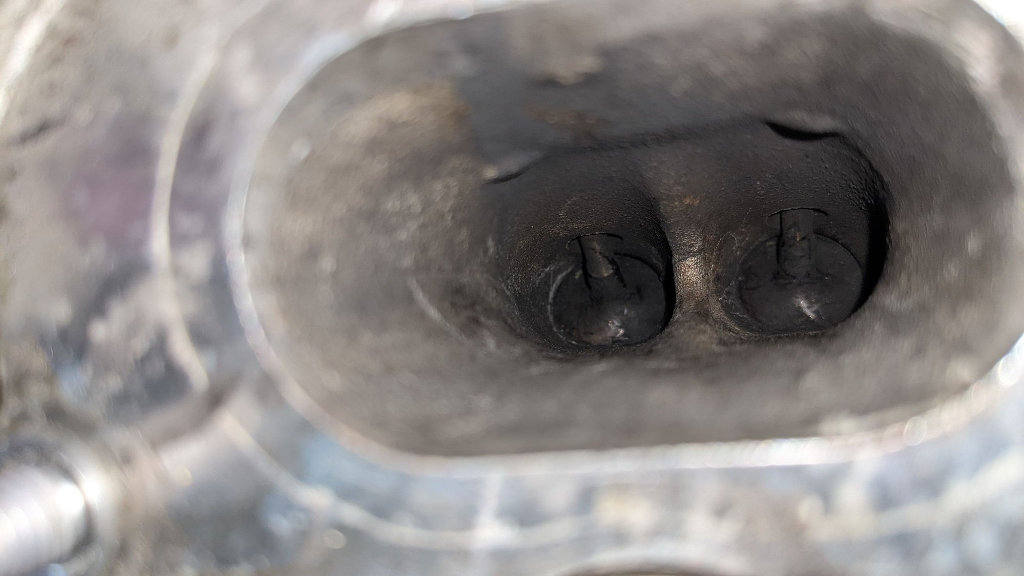

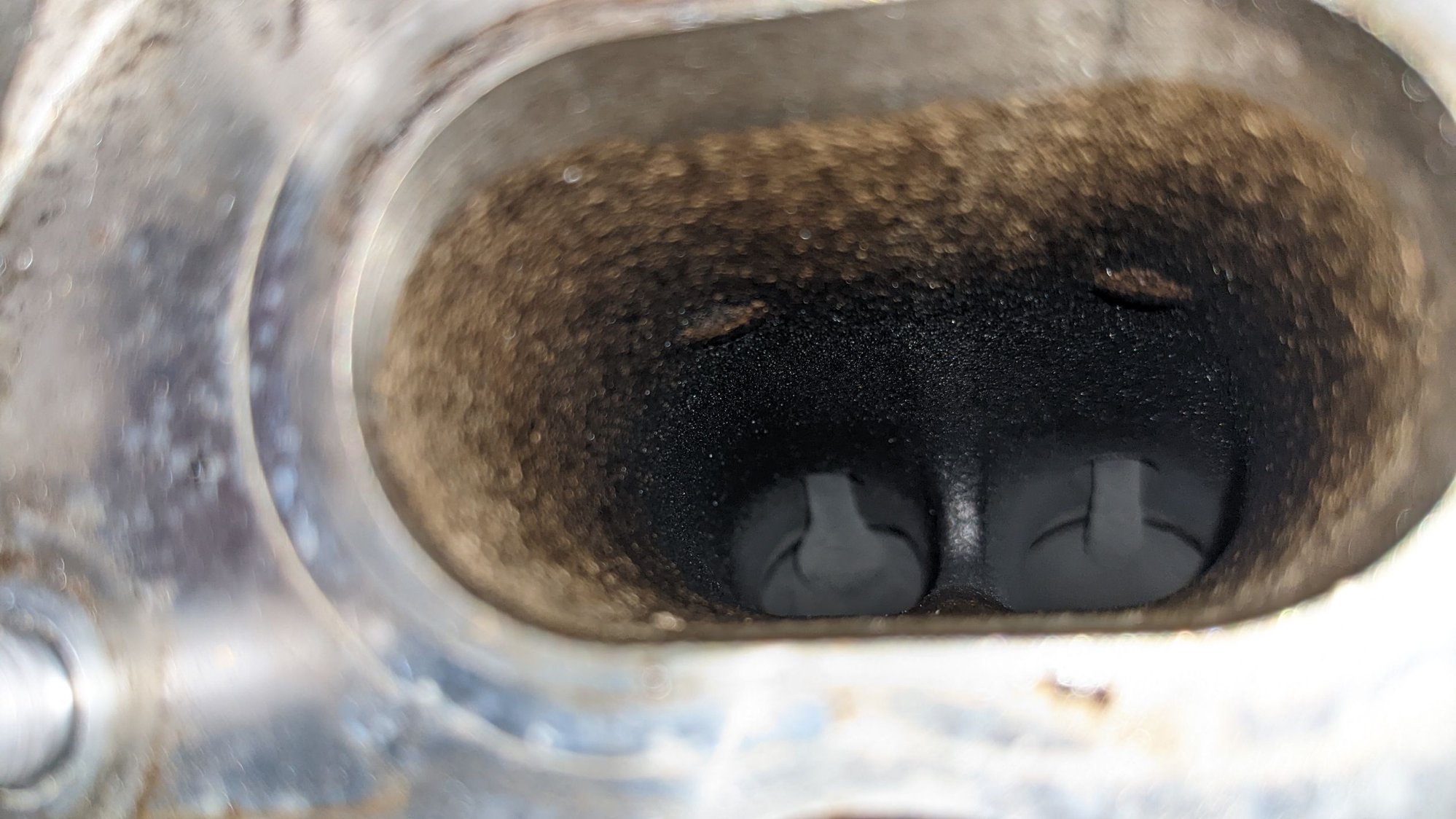

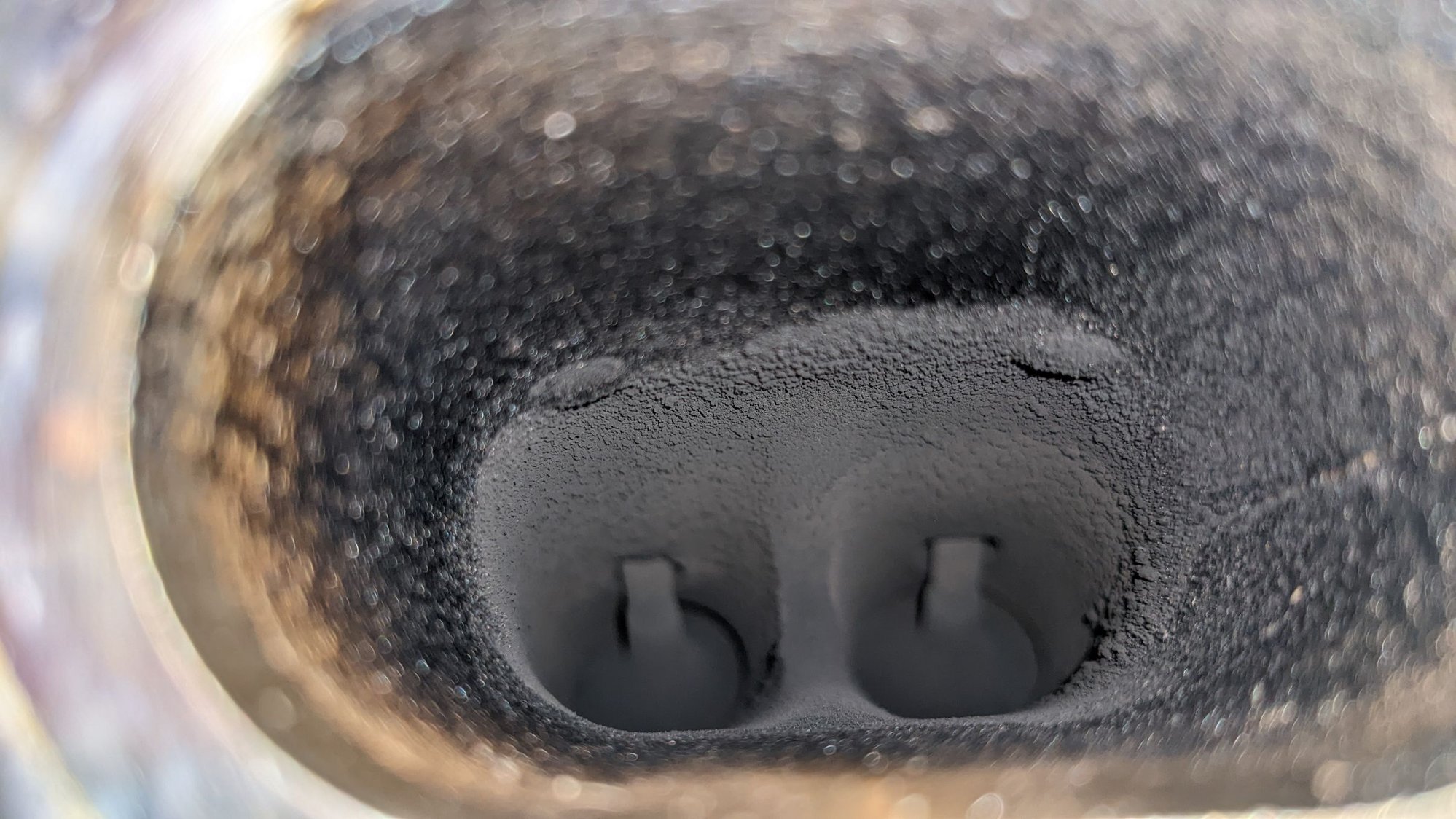

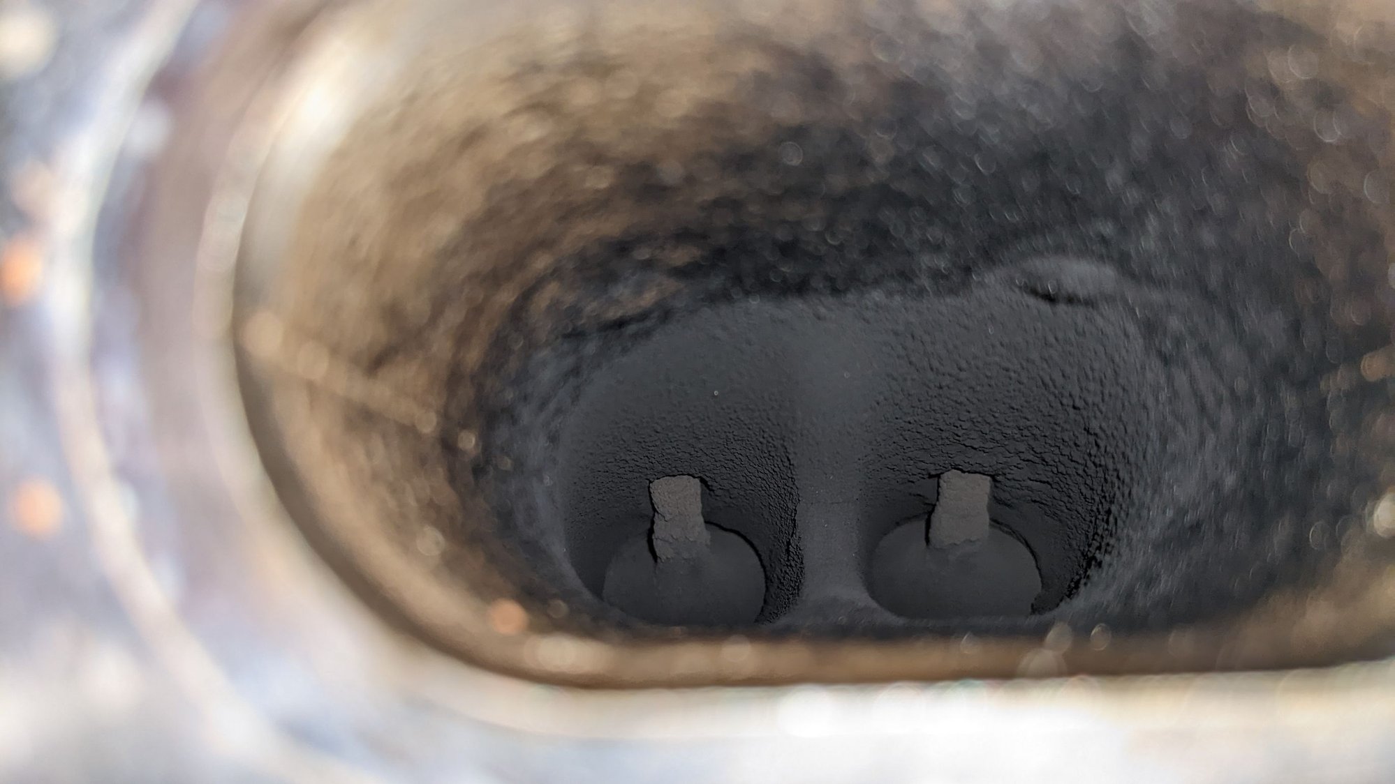

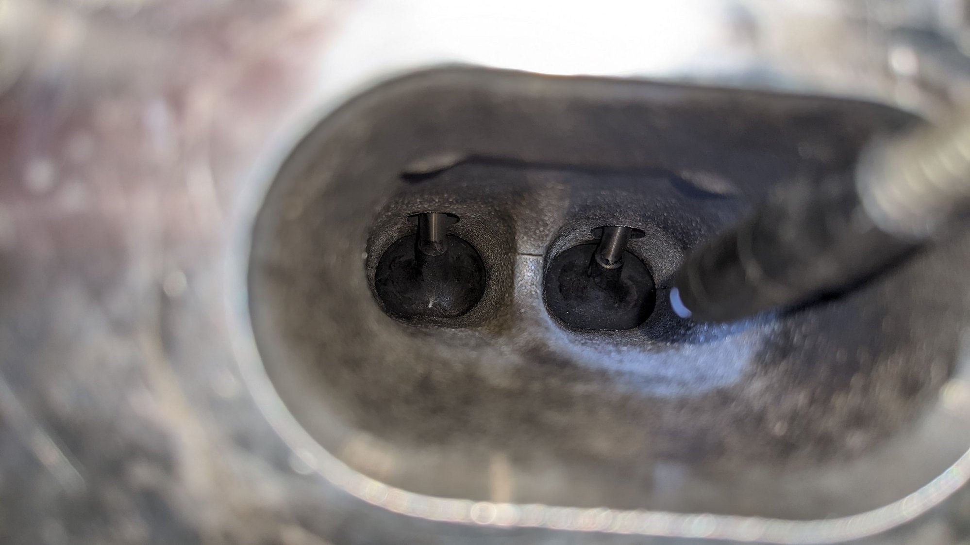

I installed 2 oil catch cans end of summer 2022, walnut blasted the intake valves in November 2022.
Before blasting: (Note this replacement new engine has about 30k miles when pics taken)
They looked like this after blasting and scrubbing:
I took intake off yesterday. 13 months later and MAYBE 5000 miles (I can get an exact mileage later) later and the valves looks like this despite 2 catch cans.
The passenger side PCV is the one that collects 95% of the oil, but honestly they haven't helped much at all.

Catch cans won't prevent coking of the intake valves. What you need is a water-methanol injection kit.

Oil catch cans were not invented to keep valves clean. That is snake oil that has been pimped and regurgitated by morons who get most of their info from facebook. Oil Catch Can manufacturers have grabbed onto this nonsense and use it as a marketing tool... oil catch cans do A LOT for a motor. The one thing they do NOT do it prevent coking on the valves.
What oil catch cans DO is massively reduce (not eliminate) the amount of blow-by that is making it into the combustion chamber. The reason why this is beneficial is because blow-by is not combustible. The more blow-by that enters the combustion chamber, the poorer the ignition is. On a stock vehicle with a stock tune, it doesn't matter as the cars are designed, manufactured, and tuned to accommodate this. However, when you start modifying the car to bring in MORE air, expel MORE air, increase boost, and advance timing (to create more power), you heat up the combustion. This is why folks who increase boost need cooler spark plugs. When doing this, you also need to ensure the most efficient combustion possible.
Enter the oil catch can. The Oil Catch Can reduces the blow-by that makes it into the combustion chamber and thus allows for more efficient and hotter combustion.
With that said, since no Oil Catch Can eliminates blow-by 100%, the first thing to get fouled up by the blow-by that does make it past the can is the intake valves.
So again... Oil Catch Cans are NOT tools to keep a motor clean and if folks have no intention of tuning the motor for more power, there is no real benefit.
As noted above, the very best way to keep the valves clean is to install an WAI system. That is, a Water/Alcohal Injection (a.k.a. methanol) system.
so, before you come here saying Oil Catch Cans do NOTHING....understand that Oil Catch Cans Do now, and have always, and will always, do exactly what they were designed to do.
