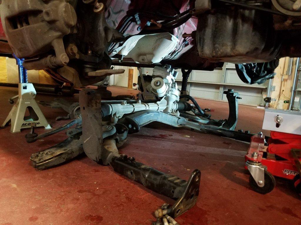

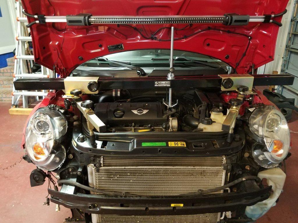

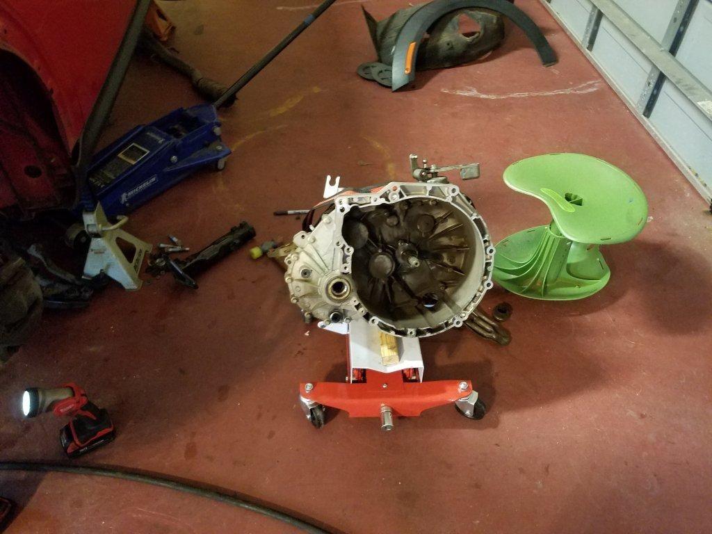

You don't need a lift. I replaced the clutch in our '07 Justa with no issues. As you can see from the pictures, you don't have to put the front end in the maintenance position, but you do have to drop the sub-frame. Word of caution, when you disconnect the pinch bolt on the steering linkage (inside the car) make sure you lock the steering wheel so it can't turn. If the steering wheel (SZL module) and the steering rack sensor don't agree as to where 0 degrees is, you'll have all sorts of problems when you power the car back up.

Dang it. I swear I have measured the clearances like 15 times and I just could not see how it would work. But I've got that exact same transmission jack and you clearly did it. Can I ask what the distance ground to frame rail was in that pic? If you can estimate?

I'd say about 18" between the floor and the rail at the point where you see the front jack stand.

I did my clutch on jackstands as well by watching this video. And by following pelican parts guide. But 100% do NOT put it in service mode. I did that but it was a waste of time when I ended up dropping the whole subframe

Jack stands here, too. Also, can’t do “service position” because the front radiator carrier relies on the subframe for support in service position. Since you’re removing the subframe, there is nothing to support the radiator carrier.
