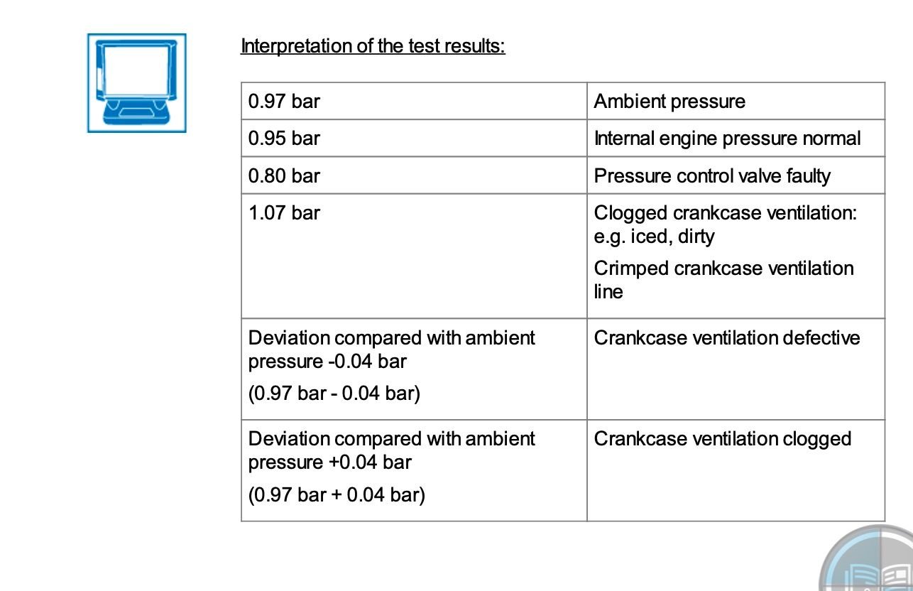

The above from a MINI COOPER F56 HATCHBACK workshop service manual.
Wow. Internal vacuum of 0.02 bar is normal and 0.04 bar of vacuum is defective PCV. Pretty small number considering on a normal engine it might be twenty times that amount. I got about 0.04 bar but before I make a final decision, I need to verify the zero point on the gauge as these two numbers are so close to zero.
It looks like mine fluctuates around 0.035 bar so I’m going to replace the PCV diaphragm and hope for the best. At least it is a cheaper and less intensive solution than replacing the valve guide seals.
