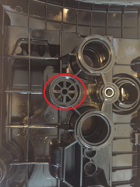

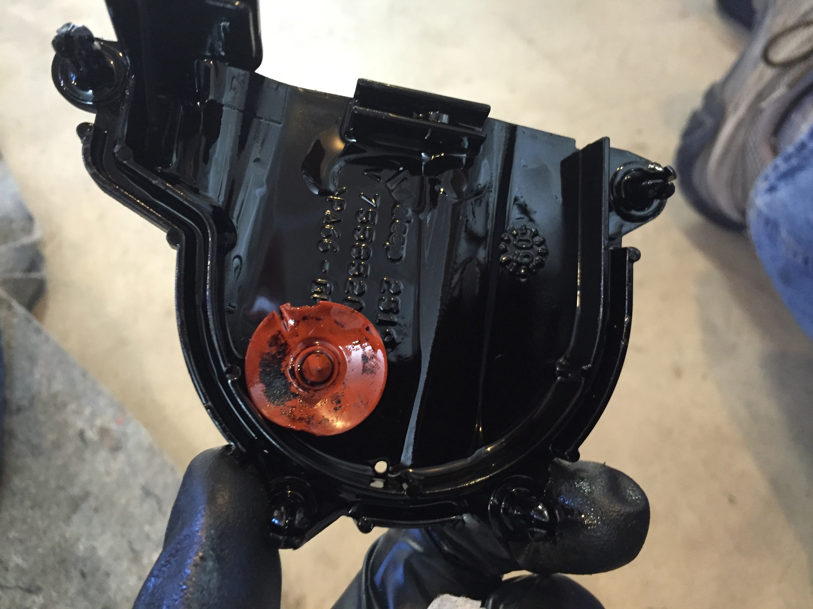

Your getting oil blow by from the PCV and the faulty PCV is causing the laggy performance because it is basically a vacuum leak. Replaced the valve cover on our 2010 last year and made a world of difference. Here are pictures of what failed on the valve cover. I ended up having to drop the oil pan to find the missing diaphram. Lucky it hadn't been chewed up.

I'll have to agree with you on the PCV. I had a code P2178 come up twice last night, it appears as though the plastic cover holding down the diaphragm has a broken clip, not holding the valve down, tried rigging it for now, made a world of difference!! I am however still going to order a new cover for good measure, thanks for the help guys, I'll let you know once the new cover goes on.
