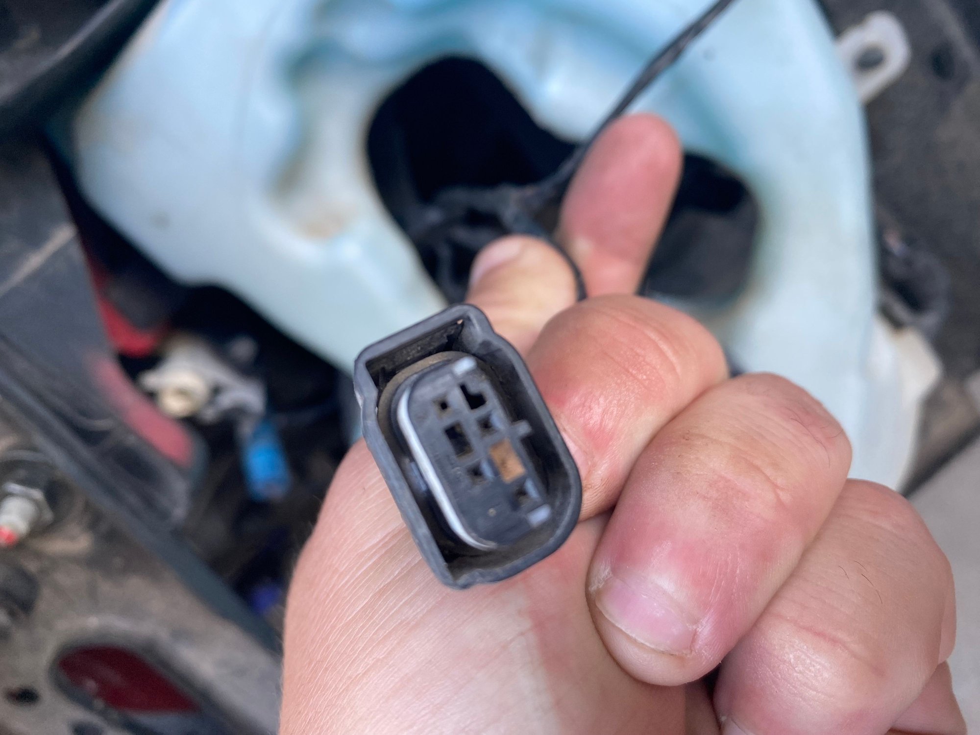

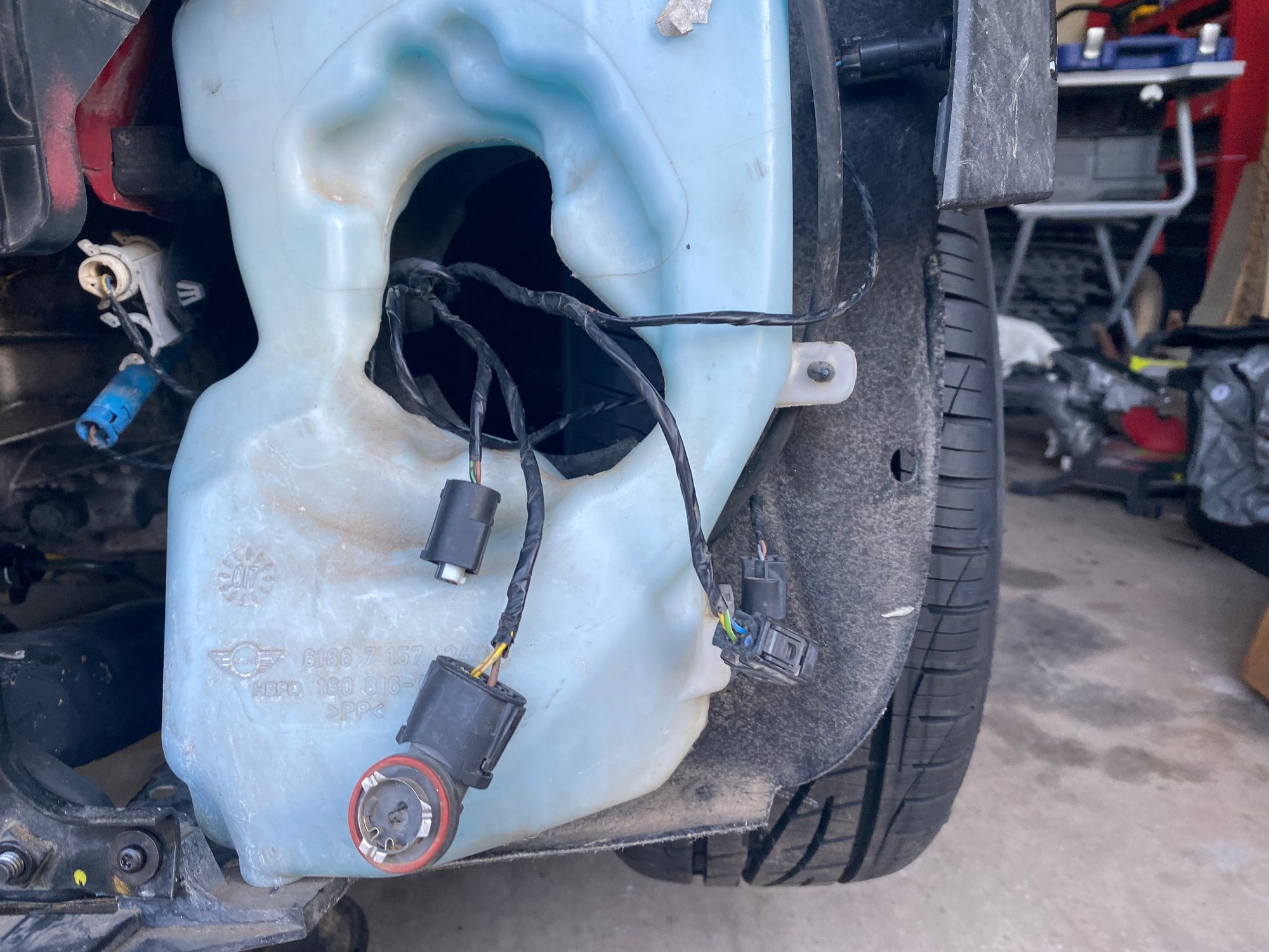

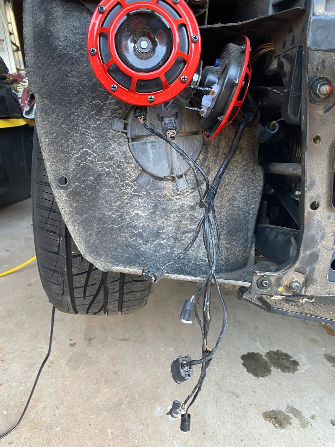

I have a 07 R56 S that I rebuilt to be awesome. However, I have some plugs that come off the left and right frame rails that just have no place. Well, they have a place, I just am unsure of where it is. Any tips to at least get me going again would be great! I been stuck now for over a month…

Well....... when you put the front bumper cover on some of the plugs go to the fog lights...... then you have the ambient temp sensor on the right side.
Have you plugged up the windshield bottle......

Once the bumper gets on there, you’ll have at least:
Fog light
Running light
Side fender marker light

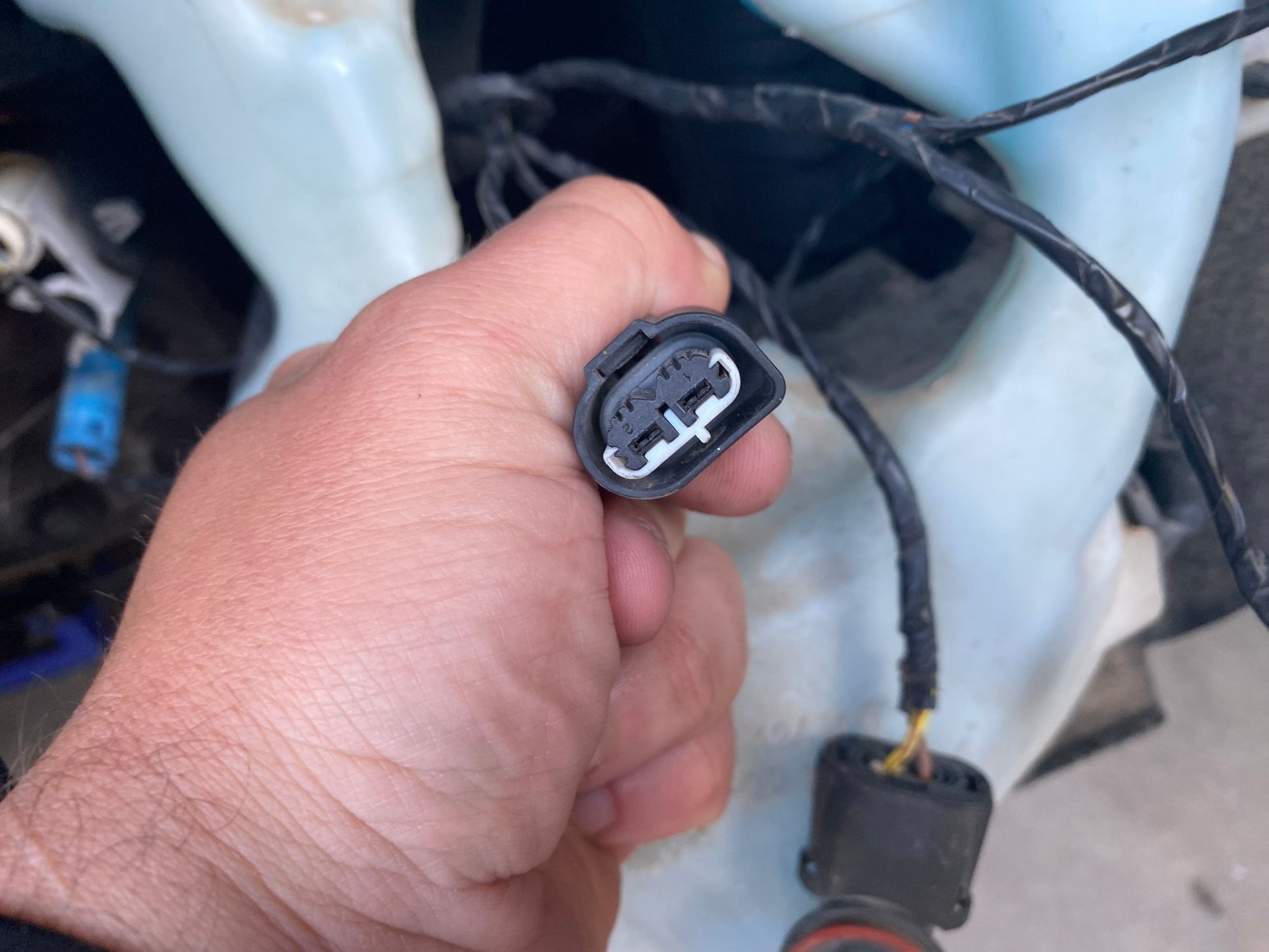

I have the fog light, the side marker light, the windshield washer resivoir, and the ambient air temp sensor. The plugs I can’t find specifically are the ones I’m showing in my fingers, and they’re on both sides.

Okkkay........ Loooook at the radiator support there's a little opening on the left and right side and little box slid into each
make sure you have both of those plugged in..........trying to remember the name and can't think right now.........look right above
​​​​​​​your horns there's an opening and little box on each side
