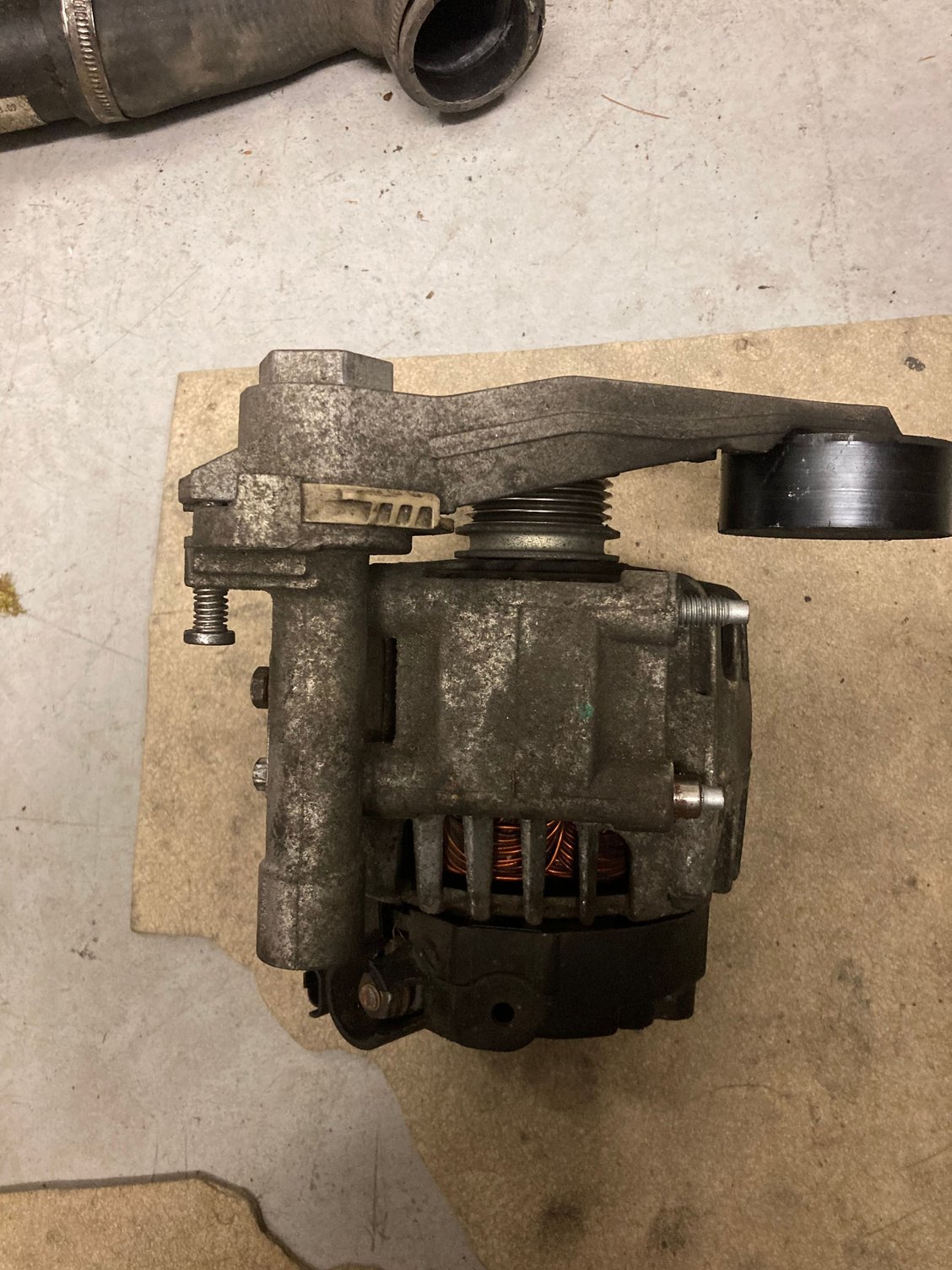

Recently I have removed the oil filter housing cleaned & resealed reinstalled.
this was a first venture into long delayed maintenance.
but I really did not know where the alternator was & when I was removing one f the cat heat shields it touched the alternator.
there was one spark, was this enough to do damage?
best I can figure the best way to test the alternator is run the engine, reinstall the cat & associated heat shields.

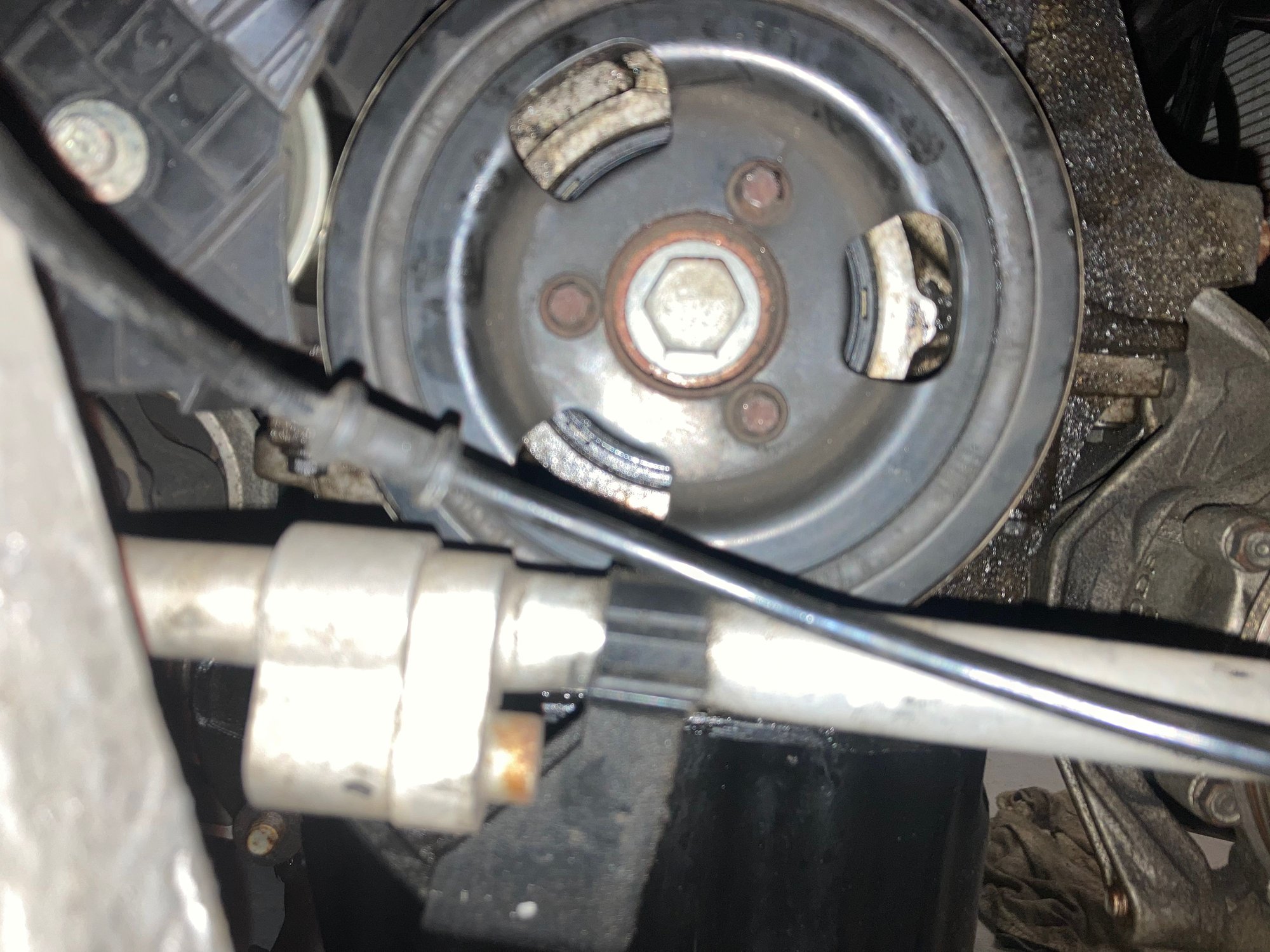

also appears some more oil leakage on right side of engine, see photo.
behind alternator & above between pulleys.
What would this be from?

I've grounded out a few alternator B+ terminals in my day because I didn't disconnect the battery when I was working. I've never damaged one, but with my current car (152K miles) I replaced the alternator because it was soaked with oil and yuck. You can always pull the alternator and have it bench checked at your local auto parts store. Personally, I'd be more worried about the DME (engine computer).
The oil leak you have in the picture is from the crankshaft hub seal. That would be the front of the engine. Be cautious here because the Bently service manual is wrong; the cranksahft hub seal is a PTFE seal. It must be installed DRY and if must sit for 4 hours before you rotate the engine. If you don't follow those two steps, the new seal will leak right out of the gate. Oh yea! Don't loosen the center bolt on the crankshaft hub either or you will screw up the timing.

the alternator I was going to get checked anyways so that will be first.

Remove alternator of course I had just installed the two lower downpipe mounts that were definitely in the way, need to be removed to reinstall.

Pulley
Assuming this is the Pulley with crank seal under it.
Bentley lists 119601, 119602 & 119603 required for install.
both Baum & Turner just list 119600 to install that seal.
who is correct before I order tools?

Those bolts are quite stiff as they probably have been there since 09, can I use heat on the crank pulley just the bolt heads?
I have a strap wrench on it but may need one with a longer handle.

the crank pulley bolts? If the cams and the flywheel are locked with the correct tools I would use an impact to back em out. You replacing the bolts? I believe they are E10..?
if that doesn’t work I’m not sure what a strap wrench is but idk if I’d use heat. Too each their own
