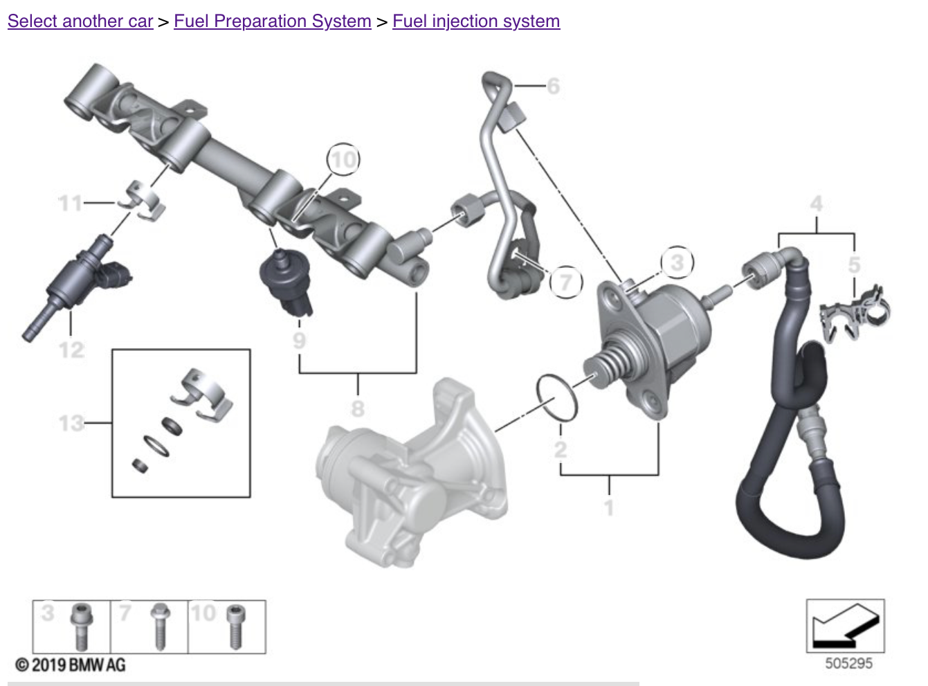

Really, there would be no way the HPFPs would be interchangeable. The controls are completely different. If they plugged in an older style pump into a newer style controls, it wouldn’t run.
That being said, you can tell just by looking at the pump which model you have.
This is the older style:
This is the newer style:

Thanks. After visual I confirmed the engine is a post 3/12, newer style pump,
Old Apr 10, 2023 | 08:36 AM
Posts: 36,759
Likes: 2,548
Yep, visual is the best and you can see in person pics here. 3/12+ you will need that adapter if thats the first time changed.
