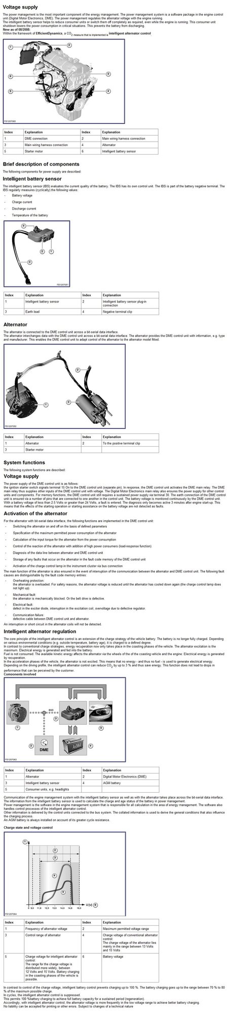

Probably need to "register" the new battery --- tell the ECU the battery has been replaced, 'specially if it has the EBS IBS (Intelligent Battery System) feature. Whether or not EBS IBS is installed can be determined by a small "box" of stuff on the battery cable. Usually a dealer chore, but maybe some scanners can do it.
Here's a screenshot of the different cables. #1 is the IBS cable.
Last edited by oldbrokenwind; Jul 14, 2022 at 05:33 PM. Reason: Correct cable ID and add photo

Whether or not registration is needed, you should find a scanner designed for Mini's and troubleshoot the codes it reports. If you're new to Mini's, you're gonna need a repair manual --- suggest Bentley's, and get familiar with RealOEM for illustrated parts lists.
Also, I added a photo showing what the two cables look like, and corrected the name --- not EBS but IBS for Intelligent Battery System --- post #2.
Staxtis presents a reasonable argument why it shouldn't be a registration problem. From what I understand about the ECU, battery voltage is monitored and used to control alternator output --- I've been told this by different Mini mechanics. When the battery is replaced, the sudden increase in voltage seen by the ECU could be enough to prevent the ECU from engaging the starter --- a WAG on my part, not so wild if IBS is installed. You might want to talk with your own Mini specialist and get their opinion.
