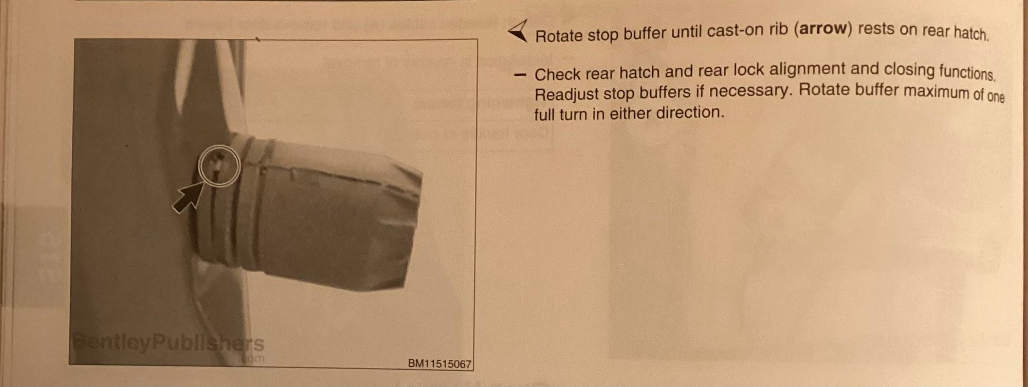

Since you didn’t mention anything about the “stop buffer”, try rotating the stop buffer to allow the liftgate fully close. There’s one on both sides.

@Vanski , I didn’t consider that as a potential solution, so I appreciate the idea. That for some reason never crossed my mind. I will try that and see what happens! Thanks!!
