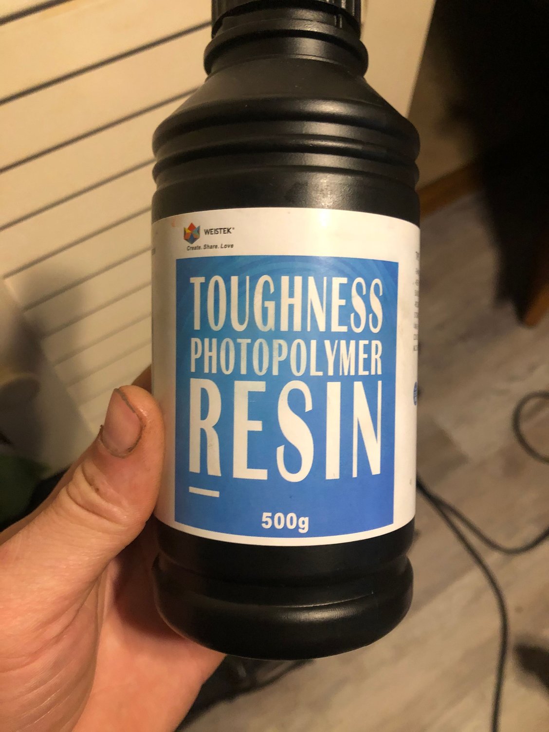

Walnut blasting attachment
Just got finished printing a strengthened photopolymer resin N14 walnut blasting attachment for my car. Thought it turned out pretty nice.
