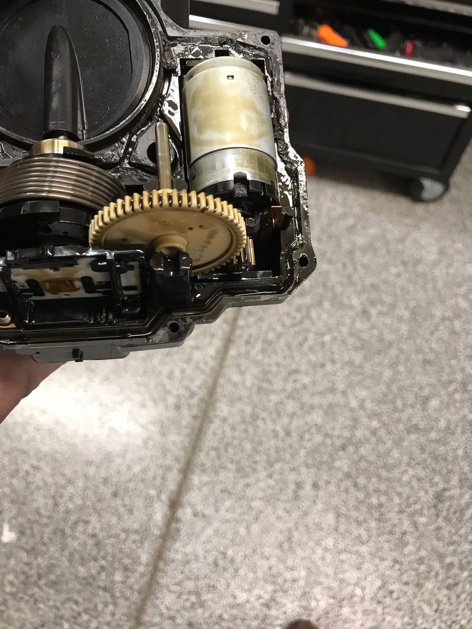

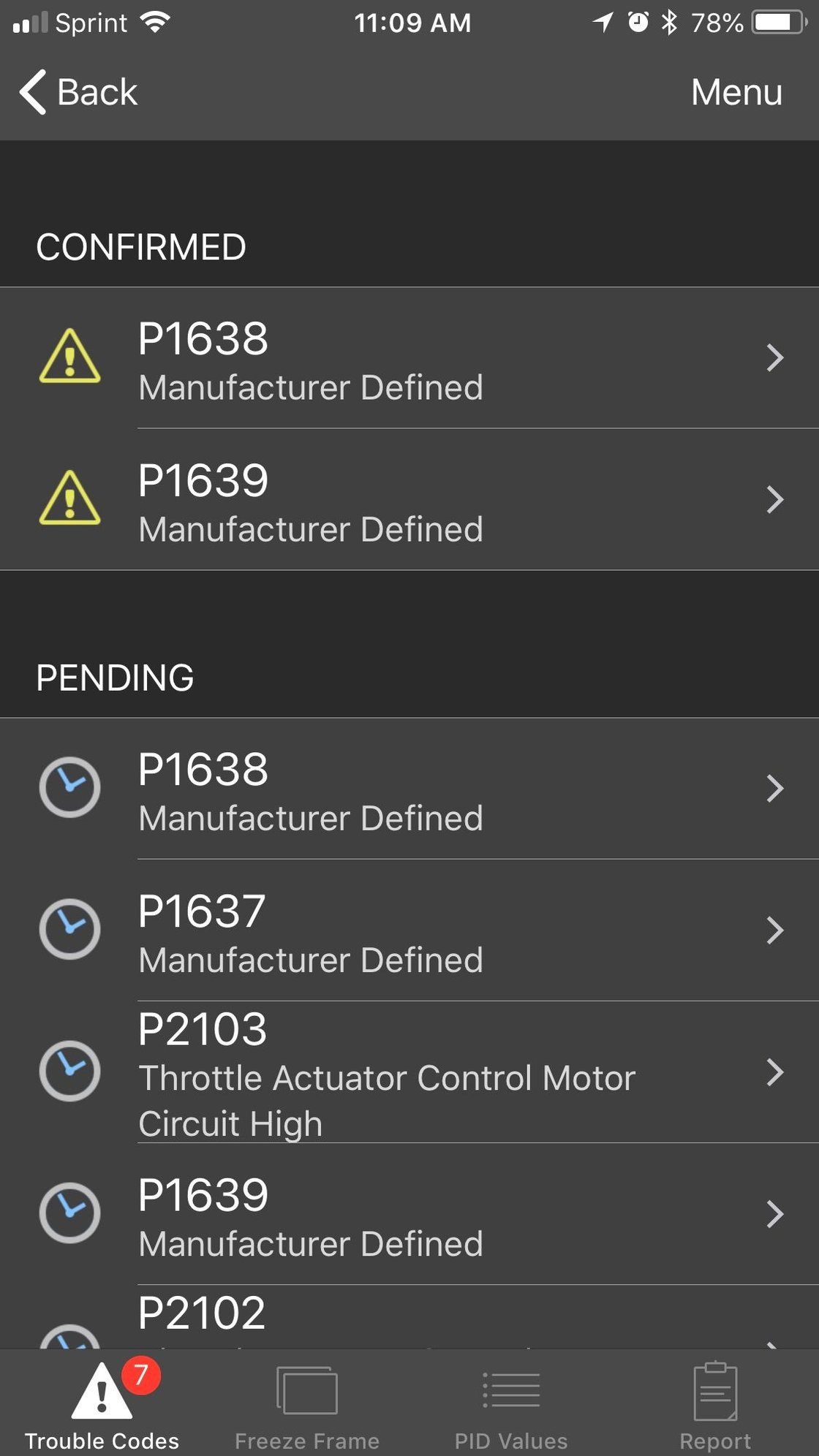

After having limp mode and a half dozen codes showing throttle body problems I replaced it. Was plug and play no recalibration needed. I decided to crack open the old one and it was full of oil. I’m guessing not the grease to lube the gears either. Runs like new again.

Thanks. That tells me it is not to be rebuilt when the shells are glued together.
