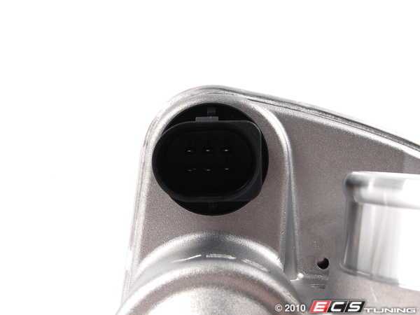

The throttle body is not hard to replace, most of the time you might get a CEL and the code will read throttle position error and point to the throttle body which is not clipped in all the way. Reclip it in and its fixed. Make sure the plug is making contact with the pins. Most of the time that's the problem. If that's still does not work then its the throttle body. Did you get a TBP error location error ? Glad it was covered
Throttle Housing / Body MCS 13541503358
http://www.ecstuning.com/Search/SiteSearch/13541503358/
You can see where it plugs into.
