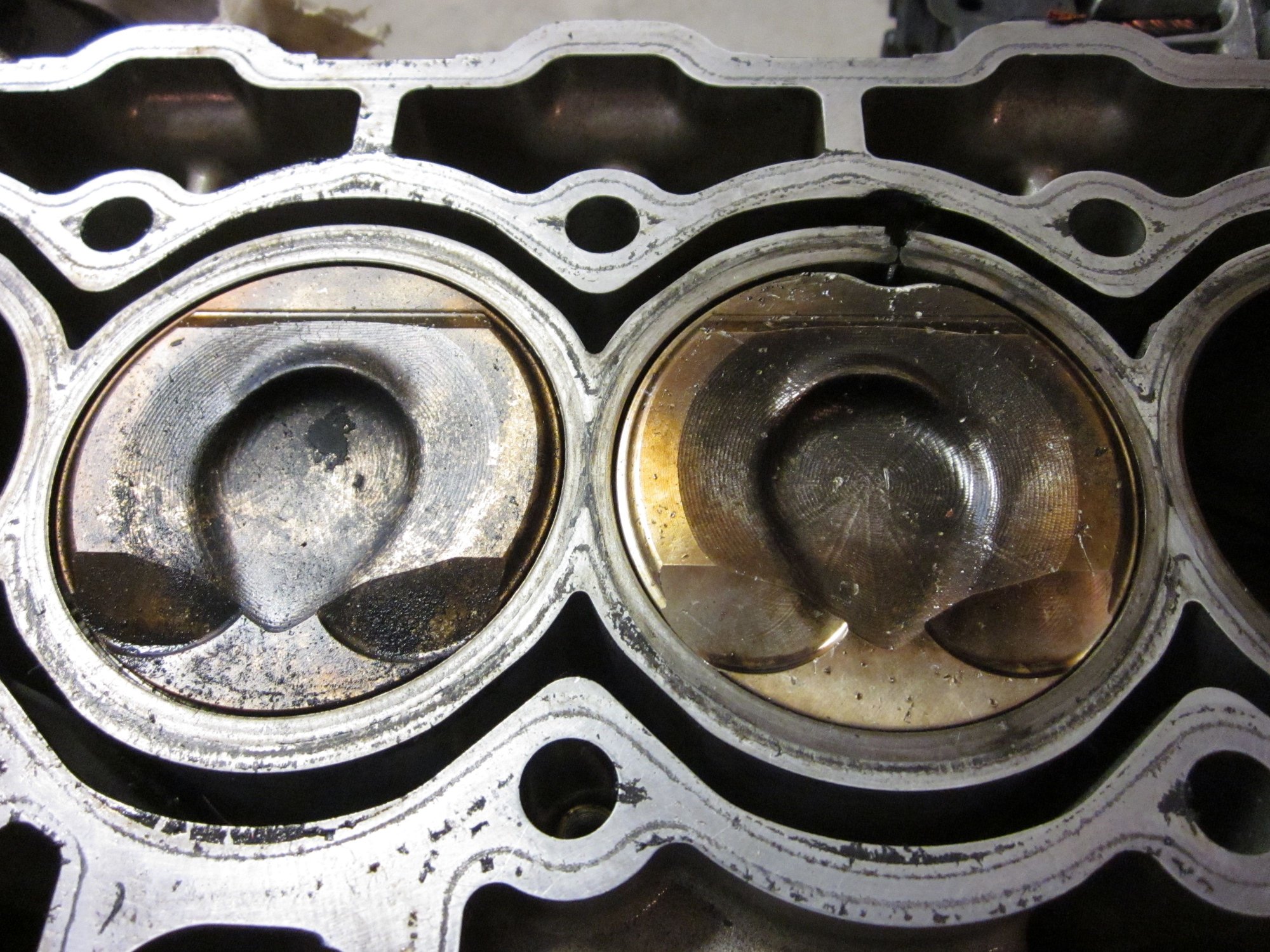

When choosing cams for my build, I was told by Manic that the 1302602 cam was not one of the cams he tunes for and the 1302603 was a better choice. Nothing was said about valve / piston clearance. When selecting pistons, I found an order form on CP's site that allows for cam lift. It wants all kinds of info I couldn't provide, but with a little help, you could order CP pistons that will work with Cat's wild cam. Note the attached pics --- one of my 10.5:1 after a run with 30PSI boost, the other of my 9.0:1 CP's after a crank bolt loosened. Both sizes have factory reliefs for valves. I would expect the reliefs to be deeper for the 1302602 cams.
If you plan to go no larger than a K04 turbo, 10.5:1 pistons might be OK, but 9.5:1 would be a safer choice. I suggest you talk with your tuner before buying anything else.
Note the broken cylinder wall / blown 10.5:1 piston. Had the thick head gasket installed too.
CSS installed to protect cylinder walls, but a loosened crank bolt still caused timing issues and bent valves. 9.0:1 pistons were smoothed out, re-balanced, and re-used.
