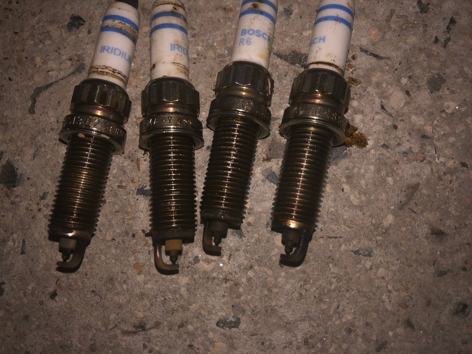

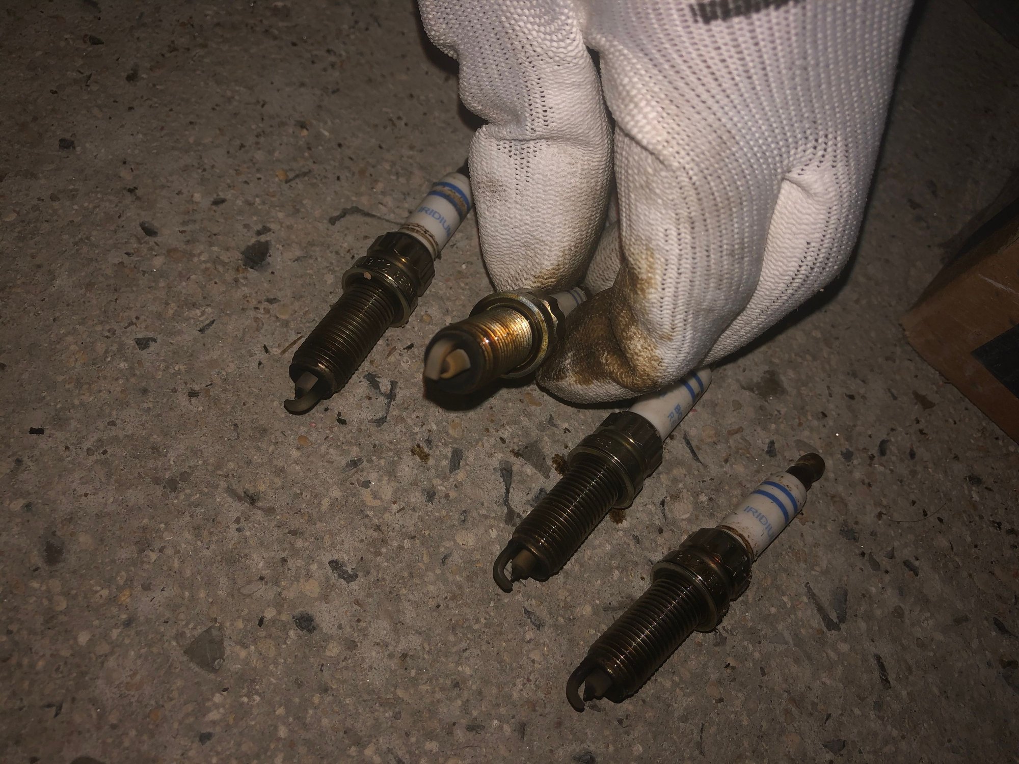

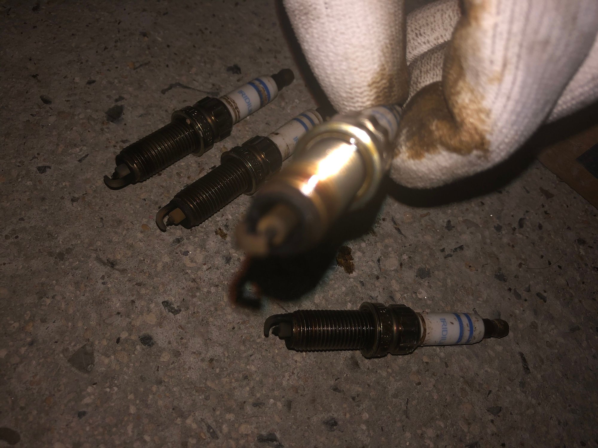

When i rev my engine a light smoke comes out but it is not continuous, and smell of burning oil also comes. For this purpose i did compression test on all cylinders, all look fine, before taking plugs out , i saw bit of oil beside them .
plugs are bit dark.
compression was Almost 220psi on all cylinders, what could be reason of smoke from exhaust ? Smoke and smell of oil !!

Compression readings look very good, perhaps on the high side?
Those plugs seem to be the correct heat range, 6, but indicate the engine is running rich.
Is the car usually used for short runs?
I think I'd check &/or change the air filter first & then maybe drive with a little more verve!

Looks more oily, last time my sparks was that bad and the same symptom to yours one of the piston went.
I wouldn't drive the car hard until you can find the problem.
Have you had any work done it recently?
Problems you have can range from faulty turbo to valve stem seals etc...

The plug on the far right in the first pic looks to have oily deposits on it. I would install 4 new plugs and change the oil and filter, maybe go a bit thicker on the oil.
